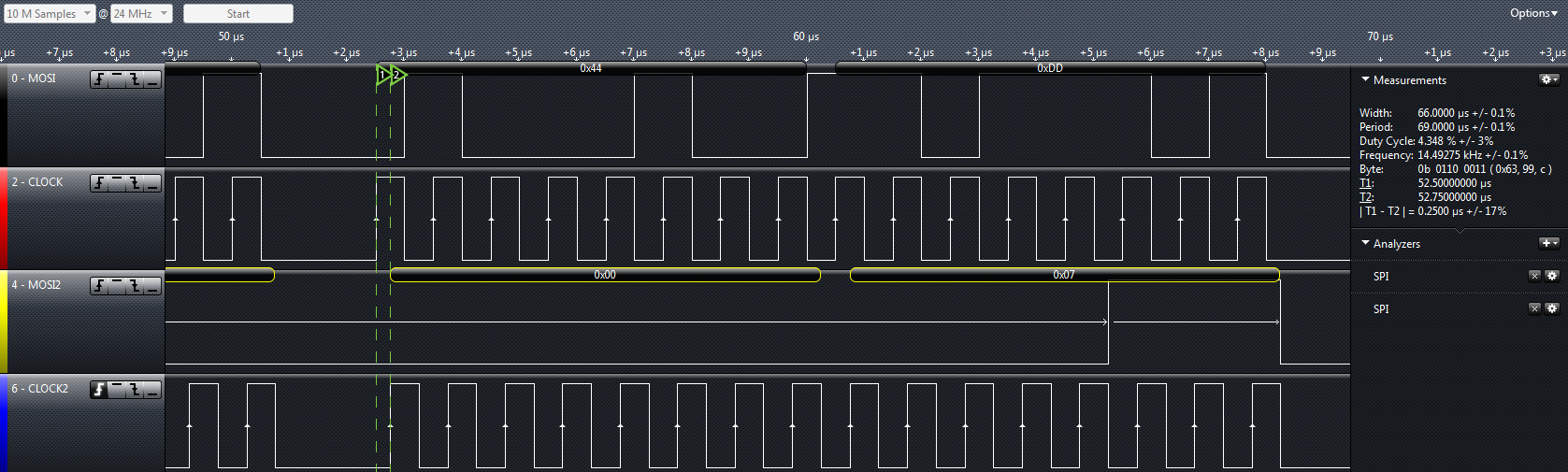

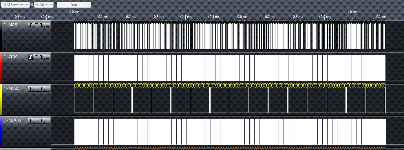

  • Hi cb,
    thanks so much for your great idea and detailled suggestion! (I nearly missed it, as when i was looking earlier into it, i saw only a short note). I appreciate your appreciation of my activities - I am very new here indeed, and hoping that I can give some of the help and advise back to others. That's the least I can try to do, plus i get the bonus of learning much quicker when I try to figure out the trouble of others. Such as you guys do, and let me say this, i am still new here but i already got to like to look into your posts and comments, when i see them. It's always good and well thought advise.
    So back to it... I like your approach very much, and i have tried to take it a little bit further. You are perfectly right with your assumption/hope concerning the "sync" of the control signal against the CLK signal. The datasheet doesn't make it very clear, but from my attempts it seems that the control line just has to be high, when the CLK signal goes high. So no real sync with the SDI data signal is needed.
    However, my attempt is to have the whole transmission, or at least most parts of it, to run in the background as much as possible. To keep my frame rate high, i want to operate at a fast SPI speed, like 20MHz. If I had to handle interrupts at least once for every 16-bit transmission, it would take me quite some bits of CPU time, which i seek to avoid.
    In my current "solution" (by now), i request two SPI transmission via uDMA at the same time, with 1 arbitration cycle. The second SPI channel starts slightly after the first one, and i just have to shift the transmitted data (which is the control signal structure) to the left by one or two bits, depending on the SPI speed. BUT i don't trust the approach, because i don't seem to have any guarantees...
    Your timer approach looks very promising first, beautiful idea counting the CLK cycles. However, i don't like the interrupts... I went straight into it and tried to somehow make the capture/compare automatically switch another pin (idealy, the control-line pin) - but that doesn't seem to work with the Tiva CPUs. (I thought i had seen something like that before on some other controller). The sketch would be: 1. Configure Timer as Capture/Compare count 2. On Match/Overflow toggle PWM pin. I would then be probably able to produce a specific periodic PWM scheme, "sync'ed" to the CLK clock. Infact I can trigger another uDMA request when the Match/Overflow occurs. This uDMA request could probably write to a GPIO pin, or even start the second SPI transmission -> but again with no timing guarantees, i guess.
    I am also thinking about some additional logic-circuitry to synchronize the signals. A 16 bit FIFO with seperate data-in/data-out signals would do. I would have the extra 30ct for such a part, if it saves me from finding another LED driver (the "other driver" will very likely be more expensive). Also a tiny FPGA to do the work would be great, but i'm leaving the price targets there..
    I'm attaching a couple of pictures, that give an overview of what the signal should look like. And, for your notice, the control signal scheme is always the same for any data transmission. Because i have four of the driver ICs in a chain, the control scheme is always:
    [nothing nothing nothing latch, nothing nothing nothing latch, ....., nothing nothing nothing end]
    This is why every 4 16-bit words there is a 3-clocks-wide pulse in the control line. In the end, there is a 5-clocks-wide pulse.
    • 0-MOSI is the data line of the major SPI
    • 2-CLOCK is the clock line of the major SPI
    • 3-MOSI2 is the data line of the second SPI, this is the control data
    • 6-CLOCK2 is the clock line of the second SPI. This would be unused later, but displays the delay between the SPIs.
    This scheme is the most important one, because it transmits LED PWM data to the drivers. This is what happens most of the time. The other control words are not so important, i can do them manually. This means that no very general dual transmission scheme is needed, basically just this scheme.
