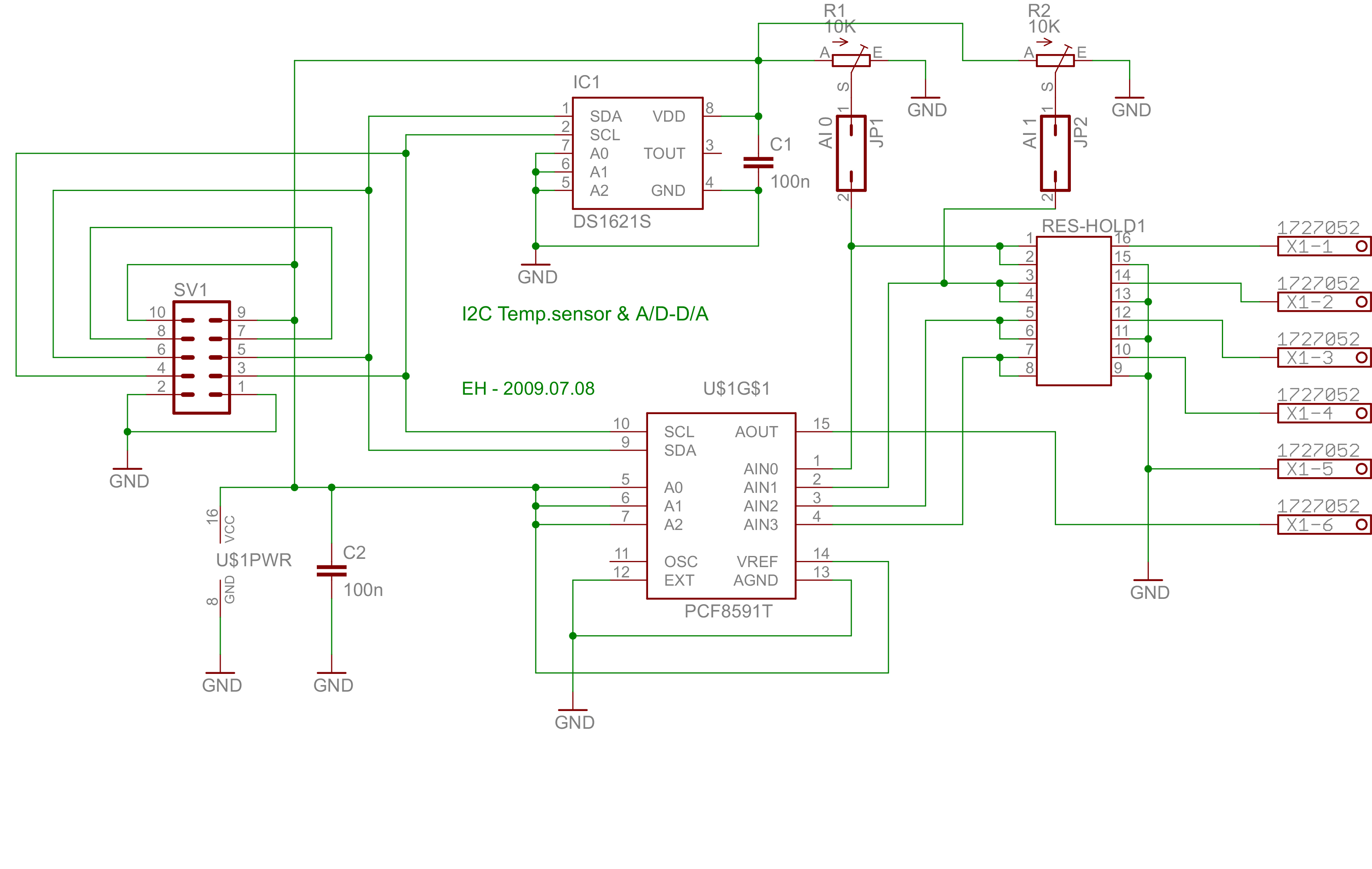

Hi, I've recently bought Tiva C TM4C1294XL board and I'm playing with it. Previously, I've worked with 8051 microcontroller and used PCF8591 DAC/ADC peripheral with it. Now I’d like to use it with Tiva and I ran into some problems. I’ve been googling for the past two weeks and couldn’t find any solution, so I’m hoping someone here has some experience with it, or can help.
Problem is that my PCF8591 acts like it’s not even connected to I2C bus, I can’t find it while scanning the bus, nor can I communicate with it.
On the other hand, if you look at the code, you’ll see that I’m also using DS1631 temperature sensor, connected to the same I2C0 bus with address 0x90, and it works perfect, I’m able to communicate with it and get temperature readings. It is also the only device I see when performing I2C Bus scan.
PCF8591 datasheet - http://www.nxp.com/documents/data_sheet/PCF8591.pdf

    Do you have a schematic of how the DAC is connected to the TM4C?
    Because if the Temp Sensor is working and not DAC, then there is something on the DAC connections we need to check.
    Amit
  • Both ADC and temperature sensor are soldered onto the same PCB which I got from university, and as I stated before, they work when connected to old 8051 microcontroller so the board is not the problem. Right now I'm using 4k7 pull-up resistors, I'll try few different pull-up resistors today, maybe that's the problem.
    And yes, when connecting to Tiva, I connect both pins 1&2 to GND, 3&4 to SCL etc.
  • Hello Vedran
    In the schematic below, the VDD and VSS to PC8591T is not shown.?
    Amit
  • Hi Amit, note on the left of PCF8591 there is U$1PWR mark with pins 8(VSS) connected to ground and 16(VDD) as VCC.
    I've just tried connecting 10k pull-up resistors and switching the above PCB on external power supply while connecting grounds, still nothing(temperature sensor still works fine), so I think it's software problem. Something with start/stop conditions.

  • After connecting SDA and SCL lines to oscilloscope I've realized that SDA line is stuck low(at 410mV) while SCL is at 3.2V (both having 10k pull-ups). At the same time temperature sensor gives accurate readings. Even when I disconnect everything from SDA and SCL lines(except for pull-ups), leaving only probes - SDA still stays at 410mV.
    When pull-ups removed both lines fall between 20-50mV.

    2. Change the System Clock to 16MHz PIOSC instead of 120MHz PLL.
    3.Remove the Temp Sensor and capture the first I2C communication for DAC/ADC and send it across.
    Amit
  • Changing the clock to 16MHz with following settings:
    MAP_SysCtlClockFreqSet((SYSCTL_XTAL_25MHZ | SYSCTL_OSC_MAIN |
         	SYSCTL_USE_PLL |
         	SYSCTL_CFG_VCO_320), 16000000);
    Solves my problem, finally getting response from ADC.
    Thank you Amit, and David for your help!
  • Hello Vedran,
    I believe the timing requirement for the ADC/DAC IC is 4.7us minimum to detect a START condition, which cannot be met with I2C Controller of TIVA at 120MHz. That is why I suggested to move the System Clock to 16MHz.
    Amit
