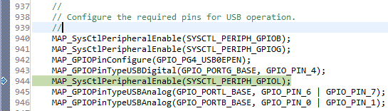

I'm little bit confused while debug LM4F232H5QD on EK-LM4F232 with Stellaris In Circuit Debug Interface in Code Composer Studio 5.5.
The reason is next:
the execution order of commands in programm isn't straight, commands are executed not steb by step corresponding to programm order.
For example, we have parrt of demonstration programm qs-logger for this EK from TivaWare package (file qs-logger.c):
When I go in step-by-step debugging using "Step Over Command", commands are executed in this order:
number of line in qs-logger.c source code: 940 - 944 - 940 - 941 - 942 - 943 - 944 - 945 - 946.
So, lines 940 and 944 are executed twice.
Why it happens?
