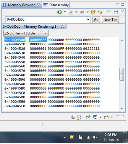

  • Hi ,
    i have done the changes as per u told, still i cant able to read data.  what else have to check,

  • hi amith,
    plz find the code attached and i am using tiva series (TM4C1231H6PM).

  • Hello mahendran,
    1. Are you using a 10MHz crystal? since the launchpad comes with a 16MHz crystal.
    2. You have set the SSI Baud Rate for 20MHz. I would suggest doing it at 1MHz first as SPI Flash are tough to communicate with especially when there is wiring involved. Also do check that the Setup and Hold time for the SPI Flash meets the TIVA Electrical Timings.

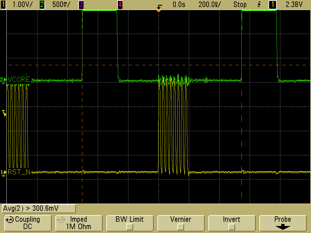

  • Hello Mahendran
    Attached is the scope plot of FSS and CLK
    I am not sure what you mean by Status of Pin Configuration. Do you mean the Register configuration?
    Amit
  • yes register configuration only.
  • Hello Mahendran
    Here you go...
    Amit
