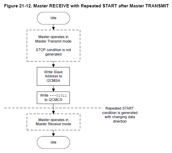

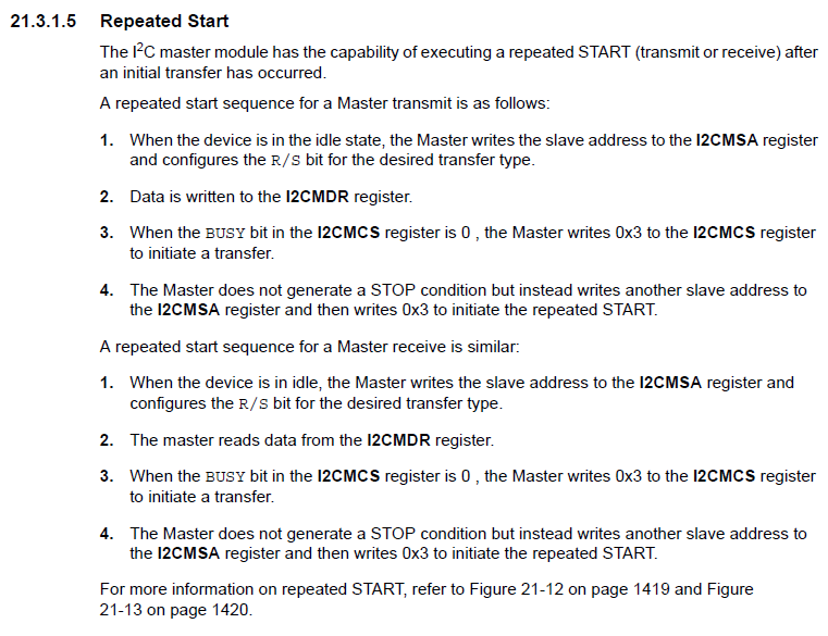

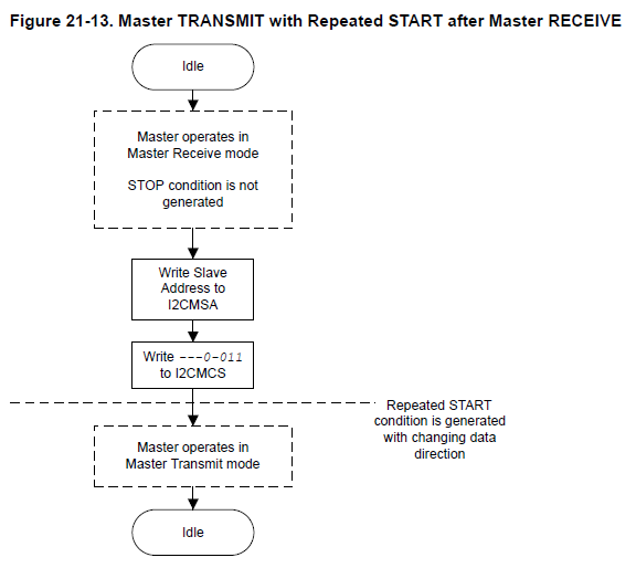

I'm using a TM4C1292NCPDT and I've got several problems with I2C.
First of all I realized the Busy-Flag in I2CMCS doesn't seem to be stable right after executing I2CMasterControl() function. I solved this problem by waiting a few clock cycles before waiting on the busy flag with I2CMasterBusy(). But maybe there is an other possibility. Has anyone had similar problems? How did you solve it?
The other issue I have is related to the error flags by reading the I2CMCS with I2CMasterErr(). The function always returns 0, although there was no address acknoledge. Am I doing something wrong?
