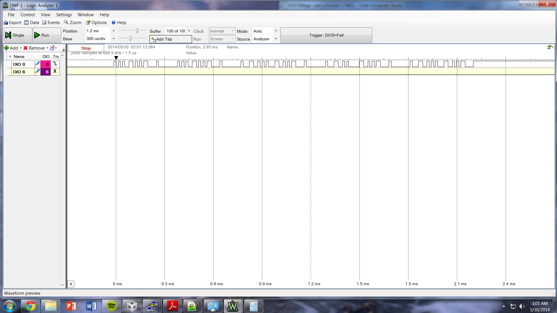

  • In case it isn't clear, I have attached a "program flow" with an example terminal conversation that shows the error is specific to UART1. I have also attached a sample output from the previous code we were discussing. Although the entire string is cutoff prematurely and isn't the correct baud-rate, this is what the transmission gate should be sending. (In case it helps, the first two groups are "e\r", the next two are "L1\R", then "L0\R", then L1\R" and then it stops prematurely).
    Thank you again for helping me,
    Jordan
  • Hello Jordan,
    Thanks for the added info. To make my understanding clear, in the case of the code the toggle itself is missing and the line stays high?
    Amit
