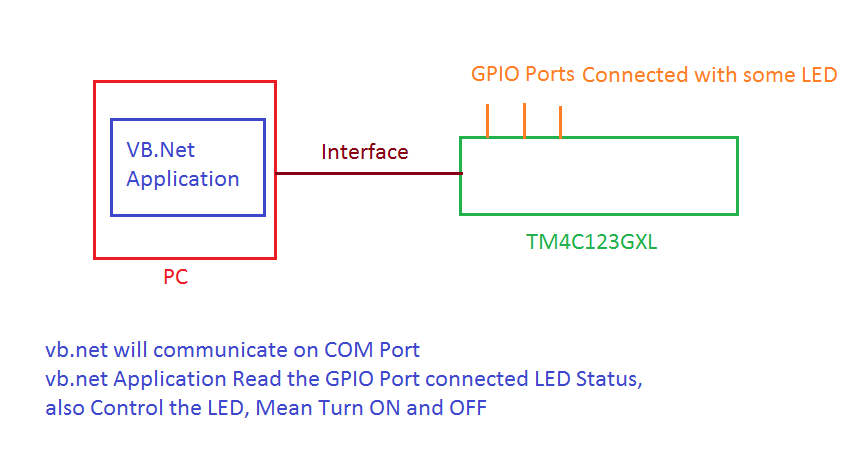

  • i make image for better understanding..
    i want to achieve to control the GPIO port pin in vb.net.
    Roberto Romano, you understand exactly, what i need.

  • Roberto Romano said:
    GPIO remain fixed IN or OUT or need be configured from external too?
    1- Switch is connected to the GPIO_PortB_Pin_0 as input
    2- one LED is Connected to the GPIO_PortB_Pin_1 as Output.
    i write program and load to the MCU.
    so when i pressed the Switch, LED Turn ON.
    when Released the LED Turn OFF.
    this is done. Now on the Programming side
    the purpose of VB.Net program is to work like HMI.
    when i pressed the swith then i want to moniter the LED Status menas   GPIO_PortB_Pin_1 status in the VB.net Applicaion
    or may be i will send some command and then the LED should be Turn ON.
    sending some command means to write value in the address of the Specific Port Pin.
    i need to implement in the TM4c123GXL  Board, not on arduino
  • Hi Muhammad,
         It will help if you study how the uart_echo works. You, can then modify it to turn LED's on and off.
