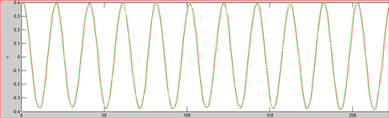

Hello all.
We are sampling 2 channels at a 800ksps rate on our internal ADC0 (set at a 2 MSPS conversion rate) on a TM4c1294 launchpad board, via uDMA and triggered by a Timer.
Those 2 channels used are AIN1 (PE2) and AIN3 (PE0)
However, at high input frequencies we are watching some delay between them (not appreciable at lower freq).
We have tried to set  ADCPhaseDelaySet(ADC0_BASE,ADC_PHASE_0) to correct the issue with no luck.
Is there a workaround to solve/minimize this problem, since it is causing a lot of pain on the output of a later FFT process.
Thank you.

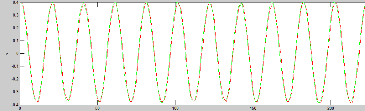

  • Amit Ashara said:
    Do note that the ADC would be making ~3 measurements for the signal.
    Which 3 measurements?
    Amit Ashara said:
    What would be useful is a plot of the signal and the sampled data, to see visually what is being sampled (if the signal is periodic).
    This is a 40kHz sin wave (from a dirty generator) sampled signal.
    Here you can see the phase difference, which happens to be "0.25-sample" delay.
    You can spot a difference of 3 dB of image carrier)
  • Let's see
    2Msps conversion rate
    • 800ksps sampling rate per channel
    • 2 channels on same converter
    • resulting in an effective 1.6Msps rate
    Does that correctly summarize what you are doing?
    At 2Msps conversion rate you would expect a value every 0.5 uS.  The sampling interval at 800ksps is 1.25us so you would expect a sampling offset of 0.5/1.25 = 0.4 of a step.  You are correct, a phase delay of 0.25 of a sample period appears low but is your test accurate enough to capture that difference?  It's not clear to me how you are determining that phase difference.
    Robert
    Actually I was thinking 1.25 - (2 samples*500ns) = 0.25 step. Maybe it is better explained your way.
