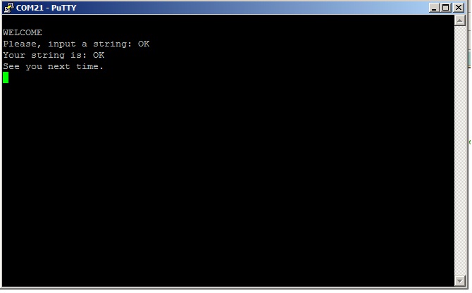

Dear All,
I want to collect the received characters from hyperterminal through UART0 of my launchapd and to save them to a string and then to print it back on the hyperterminal.
When I try to print it (e.g. UARTCharPut(UART0_BASE, *stringrecv[0]);) it prints nothing.
my code is as follows;

    First you declared this char *stringrecv[4]; then you increment i and forget to compare to the string size (only i++ is present), so you may write over other variables. But the biggest problem can be the fact the variable i may be optimized out by the compiler and never used afterwards - so it is wise to declare as volatile to prevent optimization. And don't have fear to use the debugger - set a breakpoint and inspect the stringrecv, see if there is something inside, run step by step. Keep in mind the UART debugging is only for kindergartens (although some other posters will protest to this assertion - but it is only for you….)

     Clean question so why your code has error? Unclear to me why a so strange declaration is used....
    This declare a pointer to an array of char so var is a POINTER!!!!
     None assign some value to that pointer leaving to thrash too or data value still worst!
     IMHO redeclare as char stringrecv[length] and not 4 but at almost 20 40 or more in length...
    Iftikhar said:
            uartrecv = UARTCharGet(UART0_BASE);
    *stringrecv[i] = uartrecv;
     Oh.. wow gotcha!!!
     Is not compiler say WARNING.. I think you MUST improve knowledge on what mean assign a char to unassigned pointer dereference???
     You assign a USELESS char to pointer uninitialized so you trash something in memory!!!
     You must assign something like *stringrecv = &Vectorofchar; assigning the address of a data structure!
     You are welcome next programming session ;)
     Redeclare array or assign pointer then correct your code. No ISR fault is raised?
     stringrecv[i] = UARTCharGet(UART0_BASE);
    and avoid BUFFER OVERFLOW TOO!!!!!!!

  • Roberto Romano said:
    After 40 year programming just can tell you stop messing about here!
    Mr 40 years old programmer I have fixed the problem and sharing with you so that you also learn where was the problem.
    As suggested by you I should re-attend school to learn C, but I don't know what should a 40 years old programmer do that could not figure out a small bug in the code. Oopss
    Kindly read the carefully the code in bellow, for your kind information it is now working and attached is the snapshot of the hyper terminal .

    do
    // Read a character using the blocking read function. This function
    // will not return until a character is available.
    i++;
    // Write the same character using the blocking write function. This
    // function will not return until there was space in the FIFO and
    // the character is written.
    //UARTCharPut(UART0_BASE, '\n');
    //UARTCharPut(UART0_BASE, '\r');
    UARTCharPut(UART0_BASE, uartrecv);
    // Stay in the loop until either a CR or LF is received.
    } while((uartrecv != '\n') && (uartrecv != '\r'));
    // Put a character to show the end of the example. This will display on
    // the terminal.
    UARTsendString("Your string is: ");
    //UARTsendString(stringrecv);
    UARTCharPut(UART0_BASE, stringrecv[0]);
    UARTCharPut(UART0_BASE, stringrecv[1]);
    //UARTCharPut(UART0_BASE, stringrecv[2]);
    UARTsendString("\n\rSee you next time.\n\r");
    // Return no errors
    return(0);

  • Dear Amit,
    The issue has been fixed as it was a bug in the code. I have shared the solution as well.
