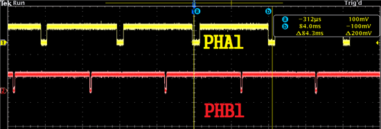

Hi, I'm using QEI in order to count a rotation of a remote car's wheel.
I connected a digital hall sensor output to QEI module 1's input A(PHA1/PC5, capture mode :  Only PhA).
The hall sensor is WSH131-XPAN3.
(Datasheet link : http://pdf1.alldatasheet.co.kr/datasheet-pdf/view/227165/WINSON/WSH131-XPAN3.html  )
Attaching a magnet to the wheel, the pulse comes out well.
The yellow pulse is the IDX1. It is constantly digital '1'.
The red pulse is PHA1. The hall sensor's output is 0 when there is a manget in front.

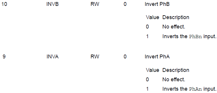

Due to the hall sensor's output, I used the invert mode.
(reference : TM4C123BH6PM datasheet, 1186pg)
However, when I read the QEI position register, it doesn't increase as i expected.
For some reason, it looked like it was reset.
The IDX1 and PHB1 pin is not connected to anything. What might be the problem..?

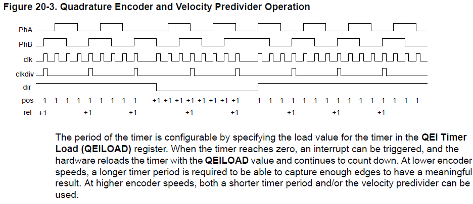

  • Hello Min-Ku,
    The QEI modules has two modes of operation:
    Quadrature mode which needs two Signals which are 90degrees out of phase to find the direction and rotation velocity
    Clock/Direction Mode: in which one signal is the pulse and other is direction.
    Based on the code attached you would need to use
    QEI_CONFIG_CLOCK_DIR instead of QEI_CONFIG_QUADRATURE during configuration and connect PhB1 to the other signal (if it is indicating the direction of rotation)

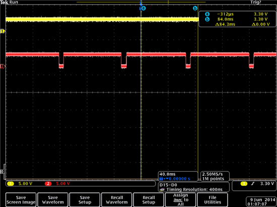

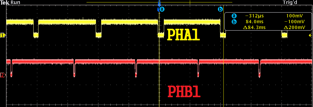

    Using the oscilloscope, the the Hall sensors were working quite(?) fine.
    (Each pulses' length of '0' was different. I couldn't find the reason)
    The picture above are the inputs to PHA1 and PHB1 respectively
    while the wheel rotates with 20% of the PWM's duty.

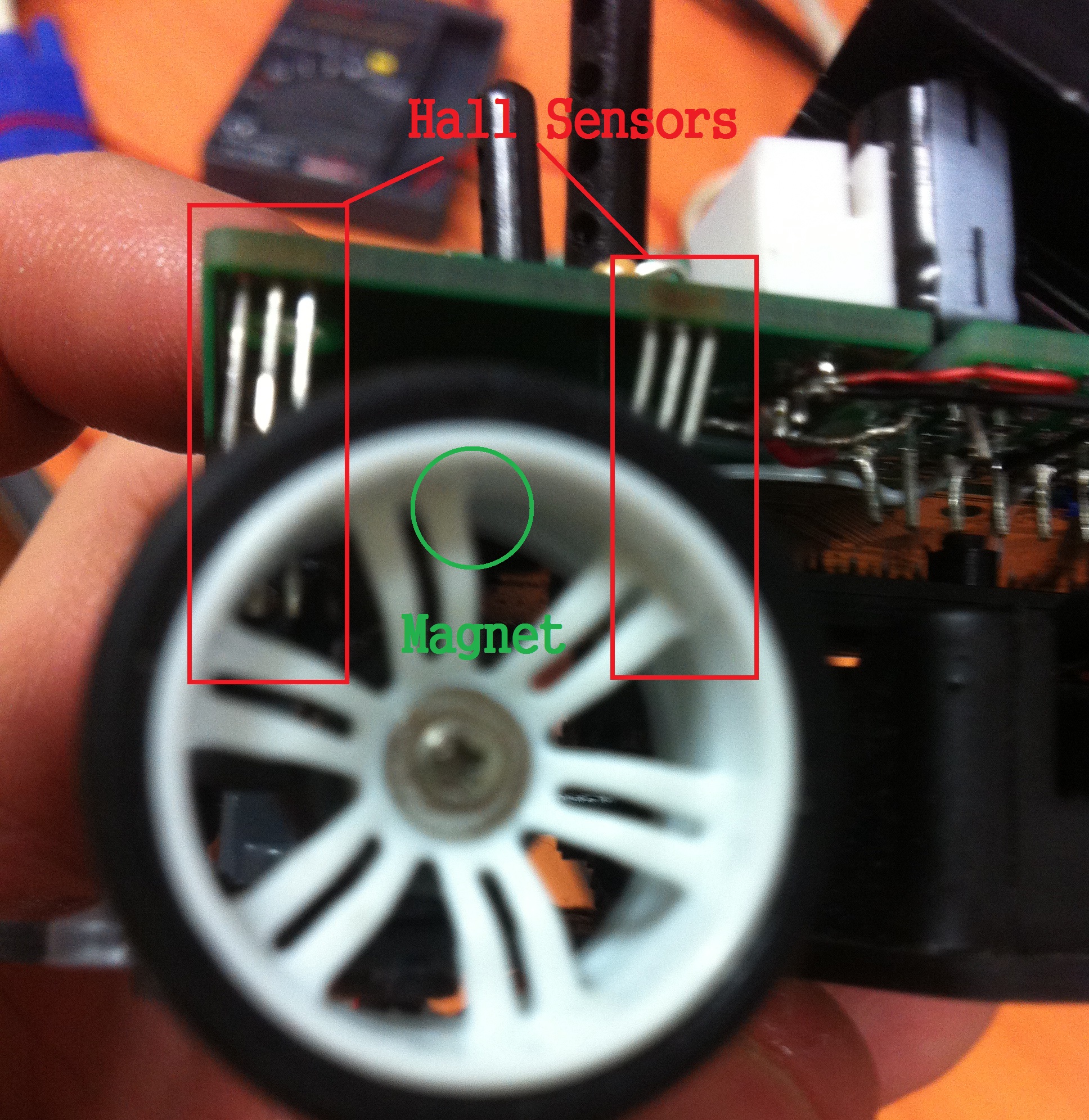

    This is how the car, hall sensors, and the magnet are composed.
    The rear wheel is attached to a magnet and two hall sensors sense the magnet.
    The right side hall sensor's output is connected to PHA1.
    Plus, when the car moves straight, this wheel moves clock-wise from this picture's view.
    I thought managing the sensors like this would be compatible to QUADRATURE mode.
    (ref : TM4C123BH6PM datasheet page 1182)
    Doesn't the pulse from the oscilloscope follows the pulse above?
    I'm having trouble to understand what signal mode to use...
    Can you explain me what's the difference of these two modes?

  • Pardon this intrusion - I'll leave the MCU-specific to the capable Amit - but I'm long experienced w/Hall Sensors/(similar) & will target that.  (to earn my keep)
    You ask about the difference in hall sensor output width.  Even sensors from the same batch may exhibit such, "difference in response" to magnetic flux.  Our firm produces certain precision, Hi-Rel BLDC Motors.  And we employ 3 hall sensors - but first we test/verify - then "bin" the sensors (10 levels) based upon their "sensitivity" to a, "fixed/known" magnetic flux.  So it is possible (I'd bet likely) that your sensor's have a slight difference in flux sensitivity.
    In addition - should one sensor be mounted at a different angle - or at a greater distance from the flux source - signal variation will be noted.  Now as these are digital sensors - the output level will not change - but the hall sensor's "recognition of flux make/break" will change - and that will be reflected by the width of the sensor's (active) logic low output.  (pretty much just as your scope cap reveals)
    For fun you may devise a test set-up which insures the sensors are equi-distant from the flux source.  I will bet that you'll note some variation - even under those conditions.
    In MCU terms this should not significantly impact the quadrature detection - and individual sensor variations can be rendered less error prone by "averaging" your time-stamps.
    Any of this make sense?  (we've not yet examined {here} the "joy of flux variation" w/in & between the different magnetic poles -w/in a BLDC motor.  It becomes possible to determine which magnet and which hall sensor are "best" - and vice-versa - via comparison of the time-stamps {duration} resulting from each/every hall impulse...)
  • Hello Min-Ku,
    As explained earlier, Quadrature Mode uses the two PhX signals (with an optional IDX pulse) and then converts it into Direction and Pulses per rotation to compute direction and velocity.
    The Clock-Dir mode relies on external Sensors (with added components) to give the direction and pulse per rotation directly to the QEI Module.
    Based on the waveform snapshot and as cb1 illustrated, it is OK to get such pulses. But having one of the pulse narrow may be causing QEI not to detect the pulse. Alternatively you can remove the filtering and check.
    Amit
  • Hello cb1_.
    Thanks to your tip :) . I'm adjusting the angel of the hall sensor to match the length similarly.
    However, as you mentioned, it doesn't seem to show immense errors.
    I'm trying to change the magnet to something else. Just looking for the suitable one.
    Thanks for your advice~
    -Regards, Min-Ku
