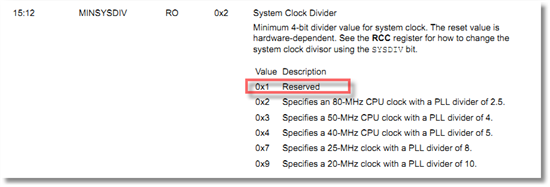

- Set CPU clock rate to 100MHz (SysCtlClockGet returns 100000000)
- initialize Timer0 A to exhibit a trigger rate of 50kHz/25kHz/20kHz (note: these are dividers of 500kHz, the physical ADC rate, so they should be attainable!)
- initialize ADC sequencer to provide a four-input ADC sequence, triggered on timer
- Handle ADC results in ADC ISR, push to USB buffer
Problem:
- Works, but:
- sampling rate at what should be a sampling rate of 50kHz is only 0.667*50kHz
- at should-be 25kHz is actually 1.2*25kHz
- at should-be 20kHz is yet different and so on, even for low (sub-10kHz) rates (== big load values for timer load register)
- I verify that neither over- nor underruns in the ADC buffer occur
