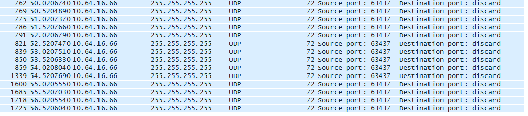

I am using the eflash utility.
eflash.exe  -m 00:04:A5:80:05:45 -i 10.-:64.-:16.-:181 --verbose typhoon.bin  to flash the firmware for Typhoon over ethernet.
but on running the utility , it continues to send the Magic packets....

Sending "Magic" packet to initiate Ethernet Boot Loader
Starting BOOTP/TFTP Server
Waiting for packet ...
... Resending "Magic" packet.
SnapShot on ethereal looks like
