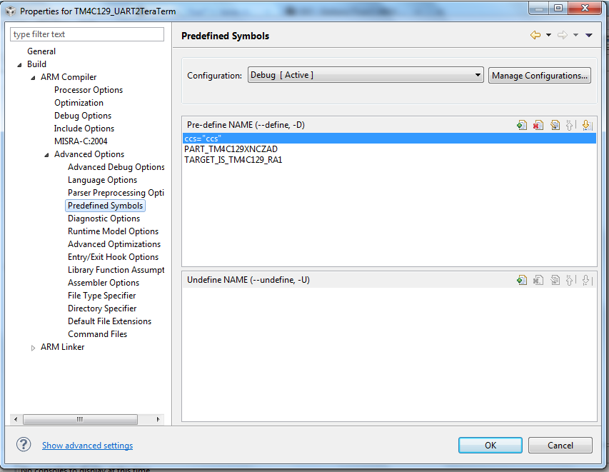

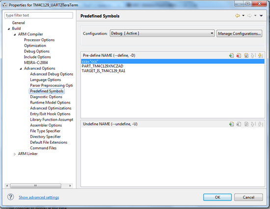

  • Hello Martin,
    Right click the CCS Project => "Show Build Settings" => Build => ARM Compiler => Advanced Options => Predefined Symbols
    In the upper box add each of the two defines. Please remember that there should not be any space when doing so.
    Attached is a snapshot of the same (ignore what I have done as my project is different)
    Amit

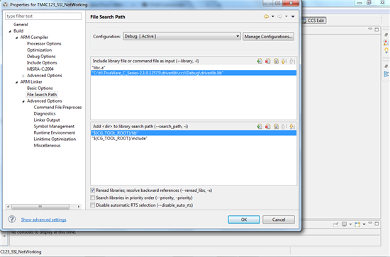

    unresolved symbol uDMAControlBaseSet, first referenced in ./CC3000 TivaC_WBSAM C/C++ Problem
  • Hello Martin,
    Yes, it is because the driverlib.lib is missing. Attached is a snapshot of how to map the driverlib from TIVAWare during linker
    Amit

  • #1: Define the below commands in the Compilation Options Menu of CCS:
    (Right click the CCS Project => "Show Build Settings" => Build => ARM Compiler => Advanced Options => Predefined Symbols)
    PART_TM4C123GH6PM
    TARGET_IS_TM4C123_RB1
    #2: Link the driverlib.lib from the TivaWare folder (C:\ti\TivaWare_C_Series-2.1.0.12573\driverlib\ccs\Debug)
    #3: Update to the latest arm compiler and CCS.
    #4: Create a new workspace and import the project in that workspace. Delete all other versions of the project. Check that #1 and #2 still are in affect when you have moved to the new CCS.
    #5: Use the pdf found at: http://www.ti.com/lit/an/spma050a/spma050a.pdf to replace all variable declarations and old functions.
