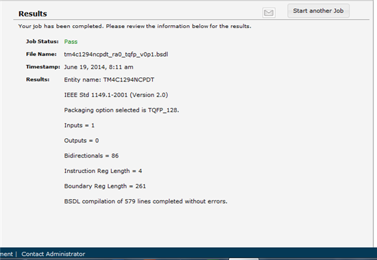

We are using “tm4c1294ncpdt”uC in our projects .I downloaded its BSDL file (tm4c1294ncpdt_ra0_tqfp_v0p1.bsdl) from TI site for Bscan testing using JTAG Pro vision tool.
I am getting below mentioned error after assigning BSDL file to the device.
 15:52:58: Device type 'B141214': Unable to construct from file 'D:\BARCO\BackedUp\Projects\Documents\Projects\TestSolution\TYPHOON\R766131\JTAG_local\BSDL\tm4c1294ncpdt_ra0_tqfp_v0p1.bsdl' (syntax errors found)
Getting following error too during execution of simple Infra test
16:06:42: Application 'infra': No BSCAN chains found
16:06:42: Application 'infra': Infrastructure generation failed
I am attaching herewith the downloaded bsdl file.
Also FYI, I found error during online BSDL file verification.Report is attached herewith.
Kindly provide me correct BSDL file at the earliest.
