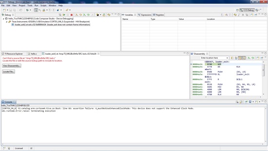

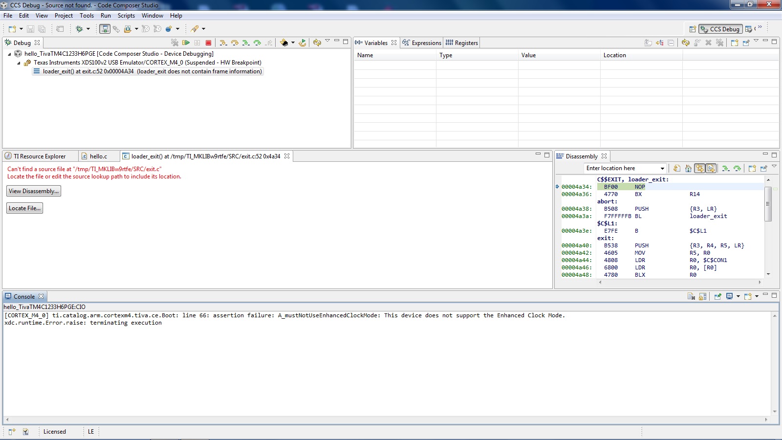

I got an error in CCS v5.4.0, when I go to debug function, the error message is:
Can't find a source file at "/tmp/TI_MKLIBw9rtfe/SRC/exit.c"
Locate the file or edit the source lookup path to include its location.
I don’t know how to solve it, can you give a help. The attached is error photo.
The hardware is TM4C123G Development Board, and connector is XDS100v2 ARM.
Thanks and regards,
Lung Tat Ng
  • Hello Lung Tat Ng,
    This means that the code executed and exited the main loop at which it will go into the exit handler.
    This is  not an issue. To confirm that put a while(1) at the end of the main function and it will stop.
    Amit

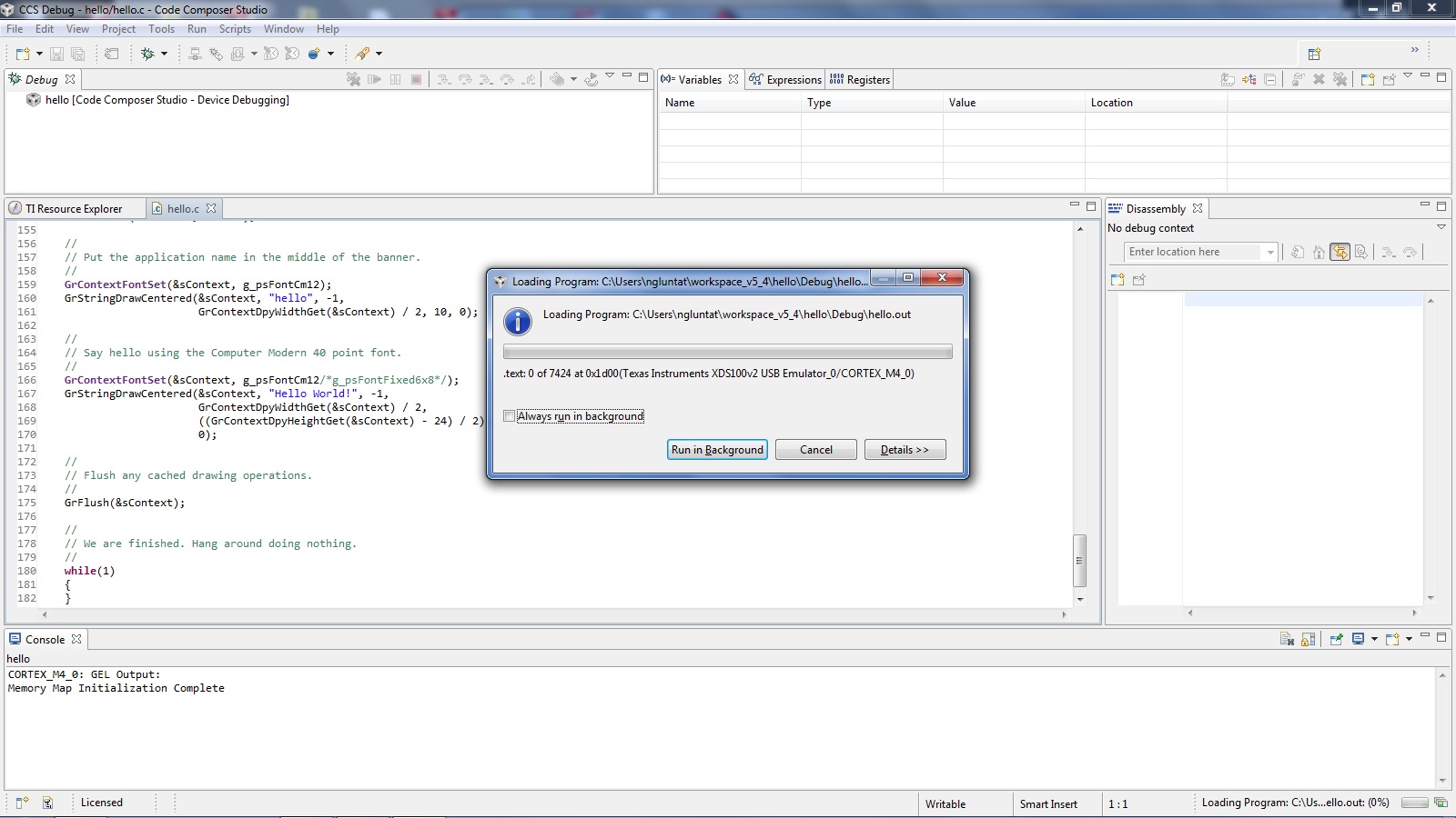

  • Hi Amit,
    The problem is happened in "Loading Program", no chance to start Debug.
  • Hello Lung tat ng,
    You would need to unlock the device using LMFlashprogrammer or UNIFLASH application with the Stellaris ICDI and then try again.
    If the same issue still comes, can you zip the project and send it across. I am using CCS version 5.5 and 6.0 and don't have an issue with the basic hello test program.

    By the way, how can I edit the file location, the CCS shows "Locate the file or edit the source lookup path to include its location", have you know where is the setting in CCS?
    I am now unclear about the issue altogether
    1. Does the TIVA Kit work with the example blinky test?
    2. Can you change the test code to hello and get the UART?
    If the file is missing, then you can add it using the button on the console. If the file is a TIVAWare file then you can add it from the TIVA Installation. If it is a ccs file like exit.c then you would need it to locate it in the CCS installation/
