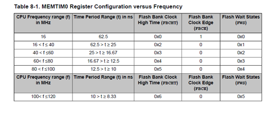

  • Hello Brian,
    At 16MHz and above on TM4C129 devices, the wait states are introduced for Flash access. You may be seeing the effects of double fetch cycles because of that.
    Change the System Clock to run at 16MHz or below and the behavior would not be seen.
    Amit

  • Hello cb1,
    This has been a part of the data sheet in the Internal Memory Section Table 8-1. I have pasted the same in the post. It may not be as serious disadvantage as the prefetch buffer size has been increased to hold a lot more of the Flash Data.
    Amit

  • Hello Brian
    The Flash for a small loop code would be reading from the prefetch buffer giving the single cycle latency, but when running a larger code it may cause prefetch flush and fill too often. On the SRAM this would be always a two clock cycle latency irrespective of the system clock frequency.
    Amit
