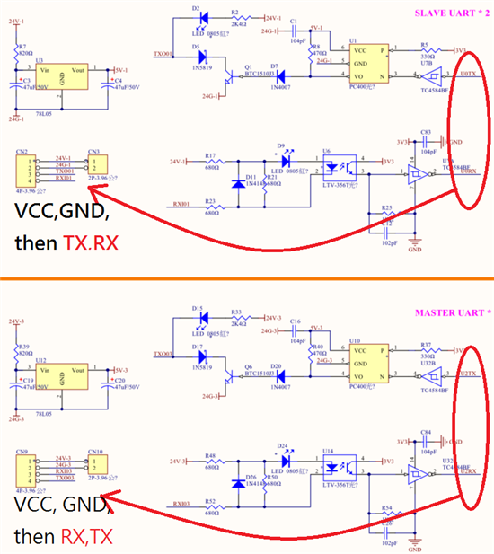

UART2 works normally but UART0/UART1 doesn't
Other Parts Discussed in Thread: EK-TM4C123GXL
I have initialize 8 uart for communication usage.
I have unlock the GPIO with special consideration but there is a strange communication in my application
I want to send a package of command via UART0/UART1/UART2 but only UART2 works.
Here is the code
