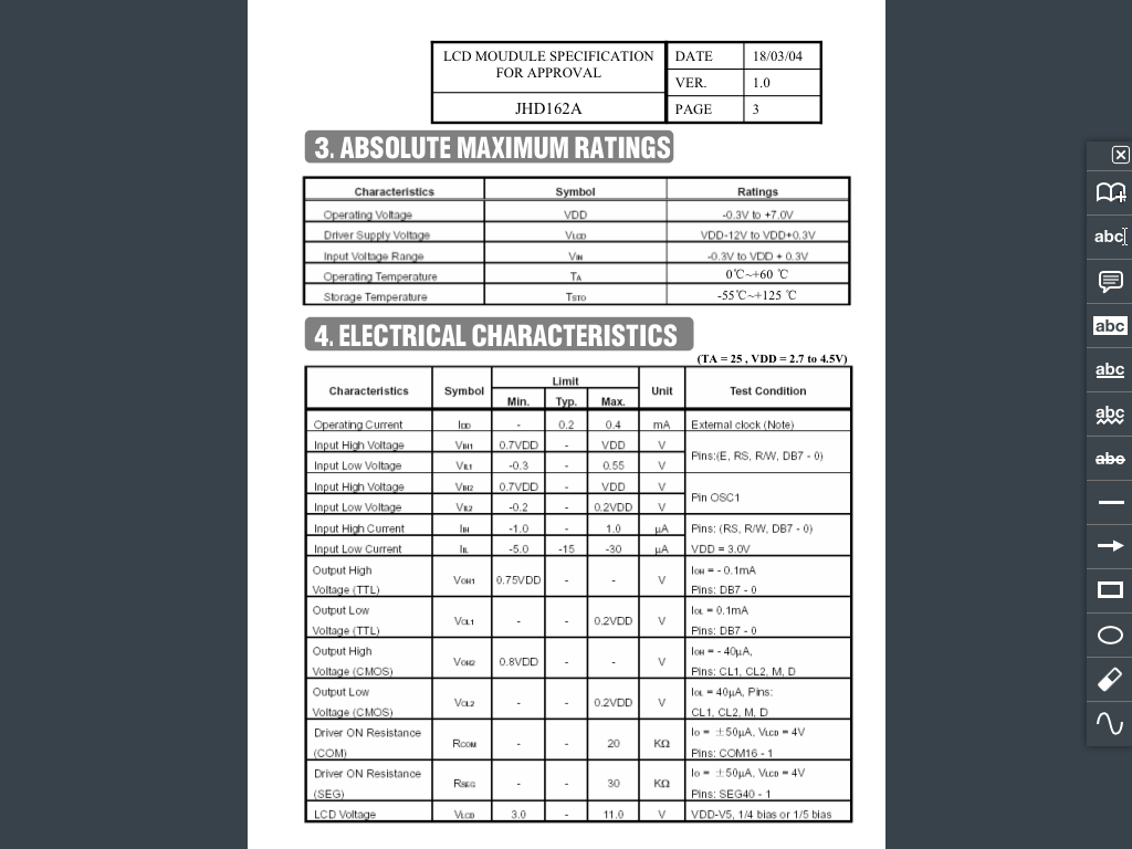

  • i have a 16x2 LCD Model: JH162A it has green backlight, if that is what you are asking

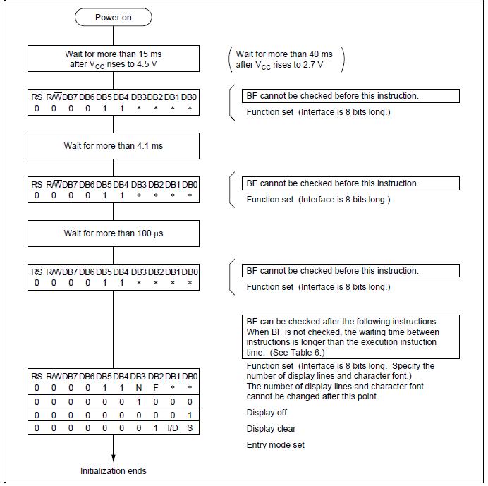

  • Proper initialization is mandatory for such displays - double check.  Your report of top character row being darker is the normal/default mode of such Lcd controllers.  The fact that it does not transition to, "each row being equal in contrast" signals that your initialization into 2 row mode has failed!
    We note that you use simple, delay constructs to achieve the "very demanded" Lcd timing.  If you have your IDE set for anything beyond low (or no) "optimizations" - such delay may be "eaten" by the compiler.
    A scope to confirm the width and clean edges of "E" is a great test method...
    As always - your use of direct register (rather than the heralded vendor library) greatly complicates debug assistance by this vendor and "outsiders" (i.e. this reporter)  As a form of protest - I avoid such posts as it eats too much time/effort - and shows less than, "Stellar" concern for your helpers...

    Longer delays between each/every code step w/in Lcd Init - rather than shorter - always best.  As past stated - the fact that your lcd retains, "dark top row, light 2nd row" always indicates that your initialization (into 2 row mode) has failed!
    Failed init stems from:
    a) improper init code
    b) improper init sequence
    c) violation of (strict) init timing requirments
    d) failure to drive RS=RW low prior to assertion of E strobe
    e) E strobe noisy, too short or otherwise deficient
    f) misconnection between MCU & Lcd's DBus or short/open etc.
    If you wish - save me the time/effort of digging into direct register - simply list here the init code sequence you intended.  Don't need any code - just the code values and their sequence - and what you believe the proper delays between each/every sequence was to be.
    What your teacher may not (fully) appreciate is that industry cannot "allow" such slowed, inefficient "learning" - our doors could not remain open - investors would not, "pile yet more cash" if "learning overtakes product shipment!"  Your school is not alone in that - one wonders if your "learning" - via assistance from others, here - will still work when school is out/over - and a boss may growl when forum response is too slow...
    Long ago we could only write code in assembler - and 10 lines per day was ok.  But - only in the most rare - most time-critical cases - would we even consider such use today!  Does not teacher's suggestion/rule make you less competent/capable w/vendor's superb driver library - and thus less employable?  (something, perhaps to consider...)

  • Friend Petrei (as always) makes good points & provides a link. (although I don't believe that simple, "copy/paste" ever meets or even approaches the proper goal of, "education/learning.")
    Let's look at your init. - 4 commands - but last one is nonsensical as 0x01 (CLS) earlier clears the Lcd & homes cursor - thus the final 0x80 serves no purpose - telegraphs confusion/ineptness.  Thus the "source" of this code becomes highly suspect. (and - it's likely that you've adopted yet more - from this (perhaps) questionable source)
    As public service - here's a scan from, "Horse's mouth" HD44780 ADE-207-272(Z)'99.9 Rev.0.0 - listing "their" 8-bit initialization sequence:
    Now others here have past posted - and the net is awash with, "singular reports of text Lcd success" - but are not all such reports really - just, "anecdotal?"  (i.e. they worked "once" w/some unknown/undescribed clone Lcd control IC)  Is that good - is that real science?  Thus I present the sequence above - from the, "father" of all subsequent text lcd ICs.
    Earlier, before eys crossed and watered (in the attempt to review the always delightful (and unneeded) direct register code) I noted reference to, "Busy."  Should you/others, "get that wrong" (often happens) each/every LINE of your code following such, "Busy Read" attempt may, "Never/ever be executed!"  Note again my public service (above) which alerts that BF (busy flag) cannot be ("successfully" - credit cb1) checked until, "3 successful writes of 0x3x" have landed!  Now I've cofounded - took past display firm public - and many times have "reduced that (3) number."  But such reduction is not guaranteed to always work - and w/some Lcds - some controllers - will (and does) FAIL!  Your code of course employs just ONE 0x3x - I trust my past, "in the biz" great experience & Hitachi data over any, "unknown, 3rd party, anecdotal, one-time (reported) display success!"
    Thus - your investigatory skills need tweaking.  Borrowing/stealing existing code (which we know to be always perfect!) is quick/easy - but at what cost?  Would not your search for, "the original" be more secure?  Did the teacher - surely interested in education & learning - sound this alarm?  Might the focus on the complexity brought on by, "direct register" have caused very predictable, "collateral damage?"  (i.e. no time/strength to properly investigate critical source data...)
    At this stage - diagnosing your issue - w/out your use of scope & confirming signal widths, delays, timings: is remarkably similar to, "Guiding a blind man - with a bad leg - through a minefield."  (gf & I perform such service - alternate Tuesdays)
    Writing 3 times, "0x3x" with even excessive time delays (as above) - cannot hurt!  At minimum brings you into compliance.
    Among the largest code errors with such text Lcds is the "common toggling" of RS/RW & E.  This results in the sure violation of RS/RW "set-up" time prior to the E signal going high.  (same data sheet (above) details)  This is done because "unskilled/unknowing" (equally bad - my book) code writers "SAVE" an instruction by "bundling RS/RW & E!"  This is most likely to land/intrude upon the change from an Lcd Command to Lcd Data.  (when RS toggles low to high)
    The abandoned KISS cries out in protest...  All hale "direct register" - but not at the expense of all "necessary" others...

    Thanks a lot for the Link, it was of great help, i have done a lot of tweaking to my code, stripped of that "cheap delay" routine and used Systick timer. i 1st tested the timer on LEds, using 16Mhz clock to provide 5, 10 s delay for the blink. and it worked as expected. then using that timer i provided accurate delays.
    here is my new Initialization sequence :
    void Lcd_INIT_ritual()
    		GPIO_PORTE_DATA_R=0; // E=0, R/W=0, RS=0
    		SysTick_Wait(256000);// 16m sec delay
    		lcd_CMD_Write(0x30);
    		SysTick_Wait10ms(1); //10ms delay
    		SysTick_Wait(8000); // 500us sec delay
    		/*lcd_CMD_Write(0x02);
    		lcd_CMD_Write(0x38);
    		lcd_CMD_Write(0x10);
    		lcd_CMD_Write(0x0C); //display on, cursor blink
    		lcd_CMD_Write(0x06); // increment on, shift off
    i realized that 2 (pseudo) initialization sequences are required, and the (0x30) first one was sort of missing.

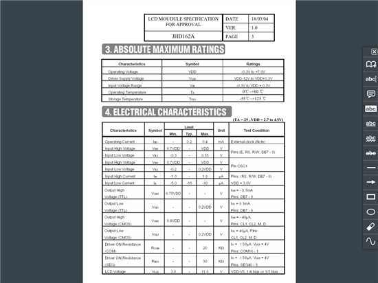

    That display spec stinks.  It lists Vdd as acceptable over a very wide range - yet lists the "Lcd Voltage (Vo)" as constant - independent of that range - which cannot be.
