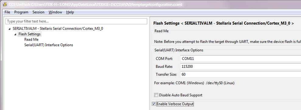

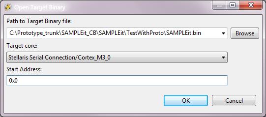

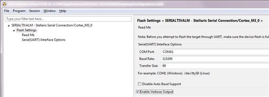

I have an issue using UniFlash tool to flash the .bin image into TM4C123BHPGE. My plan is to use the tool to program a bin image serially into an empty flash. I am pretty sure that I have configured the TM4C123BHPGE BOOTCFG settings properly, and erased the flash completely(using the XDS200 emulator). I verified this by sucessfully using the lmflash programmer tool to programmed the .bin serially. Nevertheless, I have some concerns on the robustness on lmflash as discussed  http://e2e.ti.com/support/microcontrollers/stellaris_arm/f/471/t/351027.aspx and  http://e2e.ti.com/support/microcontrollers/stellaris_arm/f/471/t/351024.aspxI therefore, I was referred to use the uniflash tool instead of lmflash as it is no longer supported.
Thanks.
The following is the steps to program:
  • Hello Ong,
    Are you using XDS200 to download using the serial bootloader?
    Amit
  • No, I am just using XDS200 to complete erase the chip, so that upon next power cycle it could enter in ROM-based boot loader mode with auto baud rate detection. After that I disconnect the emulator.
    Next, I hooked up a serial comm connection from my PC(running Windows 7) to the UART0 of TivaC chip to flash the .bin image.
    As I have stated earlier, with the same setup above, I am able to flash using "lmflash" tool but not the "UniFlash" tool.
    Regards. Amit.
    Teik Hong.
    Did you verified in Device Manager that the active com interface is COM11 as you set it for Uniflash? usually Windows may change when changing the application...
    Petrei
  • Hello Teik Hong,
    Check in the device manager of the PC as to which COM Port is being used. The default in UNIFLASH may not match up with the PC Device Manager.
    Also do check the settings as the default I have seen when using COM is 9600bps
    Amit

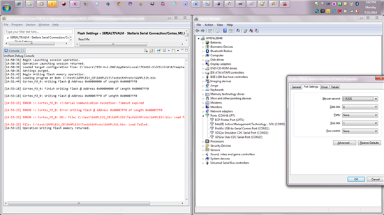

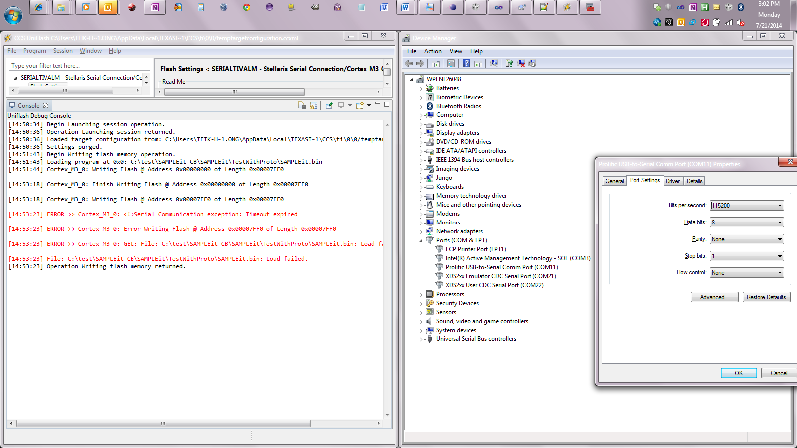

  • I did as suggested and I still get the same error:
    Per error description, can I say that it program succesfully the region 0x0 @ length 0x7ff0 but when it tried to program the next location, 0x7ff0, it fails? This means that the serial connection is OK?
    I am sure that the serial is OK...every setup I used is similar to how I program with lmflash (successfully).

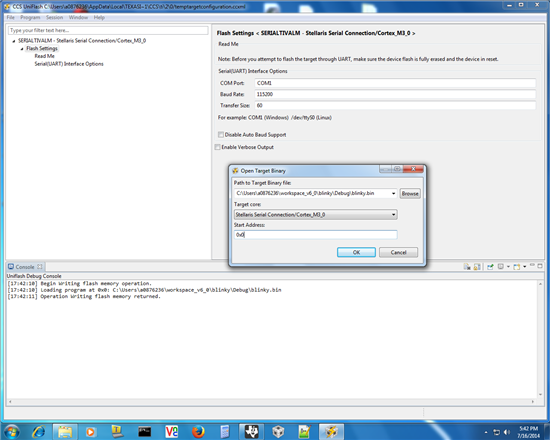

  • Hello Teik-Hong
    Yes, it worked as well. Attached are the screenshot of the settings, load window and the log file
    After loading through the UART Cable I press reset on the board for the blinky program to start
    Amit
  • AWESOME. Are your steps any different from mine, described in the first post above? Do you see anything different, or I might miss out?
    Based on your screenshot, it looks the same to what I have done.
    I am suspecting the UART cable, but that same cable was able to program my .bin image with the lmflash tool.
  • Hello Ong Teik,
    I do not see anything different between the screenshots. What I had to do was in the device manager ensure that it was 115200 bps (default was 9600 bps).
    Amit

  • I also replace my USB to serial cable with a dedicated serial cable, however the same error happen, it always fail to program at the following location:
    [15:42:46] Loading program at 0x0: C:\test\SAMPLEit_CB\SAMPLEit\TestWithProto\SAMPLEit.bin
    [15:42:46] Cortex_M3_0: Writing Flash @ Address 0x00000000 of Length 0x00007FF0
    [15:43:46] Cortex_M3_0: Finish Writing Flash @ Address 0x00000000 of Length 0x00007FF0
    [15:43:46] Cortex_M3_0: Writing Flash @ Address 0x00007FF0 of Length 0x00007FF0
    [15:43:51] ERROR >> Cortex_M3_0: <!>Serial Communication exception: Timeout expired
    [15:43:51] ERROR >> Cortex_M3_0: Error Writing Flash @ Address 0x00007FF0 of Length 0x00007FF0
    [15:43:51] ERROR >> Cortex_M3_0: GEL: File: C:\test\SAMPLEit_CB\SAMPLEit\TestWithProto\SAMPLEit.bin: Load failed.
    [15:43:51] File: C:\test\SAMPLEit_CB\SAMPLEit\TestWithProto\SAMPLEit.bin: Load failed.
    [15:43:52] Operation Writing flash memory returned.

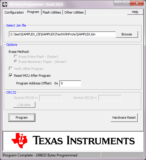

  • Amit,
    Everytime the UniFlash fails, I change to the lmflash tool, and it always program successfully. All the h/w setup(like prototype board, cables, images) are the same. The only variable is the tool.
