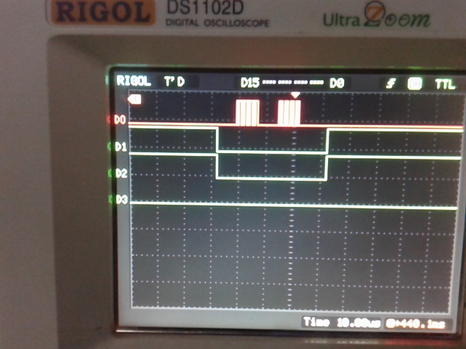

  • Hi Amit ,
    Thanks for ur reply,
    In code i configures AS SHOWN BELOW
    int main(){
    unsigned int pui32DataTx[NUM_SSI_DATA];
    unsigned int pui32DataRx[NUM_SSI_DATA];
    unsigned int ui32Index=0;

    AM stucking while sending instruction 0x10;

  • Hello Vijay,
    As I mentioned earlier:
    1. Do not use the FSS/CS from the SSI as it will send 8-bits and deassert the CS which will cause issue. Instead configure the FSS/CS pin as a GPIO and before transmitting the N bytes make it low and after completion of transfer make it 1.
    2. You are writing the data to the array and then writing it to the SSIDR. Why two operations for 0x10 and 0x02 data bytes
    3. What do you mean by stuck at instruction 0x10? Please elaborate: is it stuck in the SSIBusy llop?
    Amit

  • Hi amit,
    As per ur instructions, i am using gpio pin as cs/fss , am making low it while sending instrction1, ura, inst2,
    after that  i am reading two bytes little bit confusion with inst1, inst2, in reading and writing i ill past my code below

    in above cod ei am sending 0x10, 0x02, 0xA4, after that  am readig bytes but am not able to read am making chip select low at the end of reading
  • in previous conversion i pasted code in that am making low chip select in init only after that i am making high after read data but am not not reading bytes
  • Hello Vijay,
    The Data Bytes to be transmitted are
    0x10 0x02 0xA4 0x00 0x00
    So there are 5 bytes to be sent. When you send the 0x00 and 0x00 that is when the data is sent by the LMP device. After that you can make the CS High.
    Amit

  • Hi
    i was checking in Logic analyzer i am not getting clock pulse
    the spi initialization is

  • Hi
    due to other work i didn't completed this project sorry for inconvenience.
  • Hello Vijay,
    Please note that the CS would be 0 and SSI requires in an inactive state the CS be 1.
    ROM_GPIOPinWrite(GPIO_PORTB_BASE,GPIO_PIN_5,GPIO_PIN_5);
    ROM_GPIOPinTypeGPIOOutput(GPIO_PORTB_BASE,GPIO_PIN_5);
    Then when doing the transaction make sure that the CS pin value is 0 and only after completing the transaction the CS is made back 1.
    Amit

  • Hi Amit,
    I was CS Pin Asserting a& Deserting as you told, that's fine, i am able to generate clock, cs pin making asserting, deserting, and SDO pin is Showing same thing what were CS pin Do , k fine what about SDI pin its nothing  Showing on analyzer
  • Hi Amit
    The Code what were i pasted here, in this the clock is generating for only two bytes, for data put, and clock was not generating for data get instruction, the image i attached here is for  for one data put instruction ,and it is same for 2nd data also . but its not comming for data get instruction, D0 is clock, D1 is Chip Select, D2 is SDO, D3 is SDI
    ROM_GPIOPinWrite(GPIO_PORTB_BASE,GPIO_PIN_5,0x00); //cs make it low
    pui32DataTx[0]=0x11; // read register
    //pui32DataTx[1]=0x01; // ura
    while(ROM_SSIBusy(SSI2_BASE)){}
    ROM_SSIDataPut(SSI2_BASE,pui32DataTx[0]);
    pui32DataTx[1]=0xAF; // read +2 bytes+LRA
    ROM_SSIDataPut(SSI2_BASE,pui32DataTx[1]);
    ROM_SSIDataGet(SSI2_BASE, &pui32DataRx[0]);
    ROM_GPIOPinWrite(GPIO_PORTB_BASE,GPIO_PIN_5,GPIO_PIN_5); //cs make disable(high)
    UARTprintf("DATAFROM REGISTER = %d\n",pui32DataRx[0]);
  • Hello Vijay,
    The way SSI legacy mode in TM4C devices work, is that to get a byte you need to put a byte. So in this case when you want to 3 transactions, you need to SSIDataPut 3 times. and each time you do you have to SSIDataGet to Flush the RXFIFO. During the Byte 1-2 SSIDataPut, the SSIDataGet is to flush the RXFIFO. The Byte-3 SSIDataPut can be a dummy byte like 0x0 but the SSIDataGet would be the actual data from the Slave.
    Thanks for the larger code and scope snapshot. That was helpful in understanding the issue better.
    Amit

  • HI amit
    I am able to see in logic analyzer only data put clock pulses , for data get instruction am not getting any clock pulses
  • Hello Vijay,
    Please have a look at the following thread where the user ran into the same issue and has given a good description of the resolution steps as well.
    http://e2e.ti.com/support/microcontrollers/tiva_arm/f/908/t/391574
    Amit
  • Hi Amit,
    Thanks For Supporting to me, now spi is working fine ,due to mode of communication and clock frequency i didn't got slave out put (MISO) data i pasted here working code refer the header files TI_LMP90100.h  ,TI_LMP90100_register_settings.h  for  register  #defines you will get these header files from ti site

  • Hello Vijay,
    Can you specify what was wrong with the clock and configuration?
    Amit
  • Hi amit ,
    Actually i configured frequency with 100kHz before, later i changed frequency to 125khz and mode of communication to mode 1 so it is working fine now
  • Hello Vijay
    The device has a maximum SCLK rating of 10MHz and no-min. Thus a 100KHz should work fine.
    Regarding the Mode change, changing the mode changes the TX (MOSI) propagation and RX (MISO) sampling. In fact Mode-1 does not make sense when looking at the LMP90100 data sheet unless there has been a PCB routing length mismatch. Let me explain why.
    TX (MOSI Pin): In Mode-1 the TX is launched on the Rising edge of the SCLK. LMP90100 expects to sample the data on the rising edge. So unless the SCLK is routed longer than the MOSI then LMP90100 cannot capture the correct data sent by TM4C129
    RX (MISO Pin): In Mode-1 the RX is captured on the falling edge of the SCLK.. LMP90100 launches the data on the falling edge. So with a delayed SCLK, the data is captured on the next falling edge. If the MISO pin is routed shorter then you may be in the setup hold window of the TM4C129.
    Now if you are using wires for SSI, then you may want to see how the wires have been connected and load due to external probes or jumpers. I have in the past been able to modulate timing using a Passive Scope Probe, artificially meeting timing but ended up violating setup at higher frequency.
    Some how I am not convinced that the issue is solved fully, even though you have it working.
    Amit
  • HI Amit,
    At fist time due hardware mistake, i did not got output from slave , after that i make sure hardware connections correct, in that time i was using SysCtlClockGet()/8, i am using oscillater of 8MHZ for controller , due to confusion i checked with all modes mode1, mode2, mode3 ,mode0, TI mode, after that i used always ti mode in that time i am getting data from slave but it is not actual data after i didnot changed , i did not concentrated on mode of configuration, once more time go through the code in that time i checked by changing clock and mode by giving 100khz and 125khz, in mode0 i am geting out put from slave but 0th bit of the slave output is missing, in LMP datasheet i confused with modes .  data is capturing in falling edge so due to confusion i did wrong  ,now i configured  SCLK 125KHZ, and Mode1  so now it is working
    Thanks & regards
    vijay
  • Hello Vijay,
    I can only re-iterate the function of the mode v/s what I interpret out of the specifications (unless I am grossly wrong and may happen). Trial and error should give rise to curiosity. All the best with your application.
    Amit
  • Hi Amit ,
    as it is mentioned in data sheet of LMP its working fine up to 10MHZ, but i have AArdavark spi/i2c host for checking communication and responce from slaves (total phase spi/i2c) in that we can set sclk up to 8MHZ in that also its communicating with 125khz, if i gave more then 125khz its not giving any exact default values of resisters
    thanks & regards
    vijay
     Hey I read this thread .. crazy thread and I can understand friend CB1  "well ending" and how much can be useless... So it got very loooooooooong with SPI and now?? Appear as using I2C mode? But Amit, when we can have a good forum for real TIVA issue and not television serial or TV novel like these???
     Resistor pullup on I2C depend on capacitive load.. but reading specification of I2C and data sheet too?
