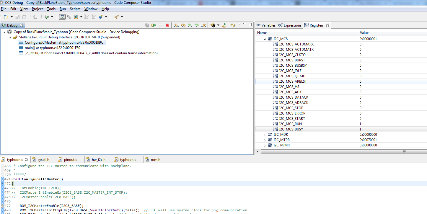

  • Apart from removing the SYSCTL_OSC_MAIN ,
    I debugged the I2C registers and found
    I2C_MCS_RUN and I2C_MCS_BUSY set as 1.
    please find attached snapshot of registers status.
    This register status is at the start of debug.
    Is this something weird or Ok ?
    Kindly suggest.
    Sanchit
  • Hello Sanchit,
    That is correct that you do not need External pull Up. But then configuring the GPIO for I2C does not enable the pull up automatically. This has to be done by writing the corresponding pin in GPIO Port PUR register. Also do note that the internal Pull Up is a weak pull up and may affect both noise resilience and baud rate due to slow rise. So it would be advisable to have external pull up on the board

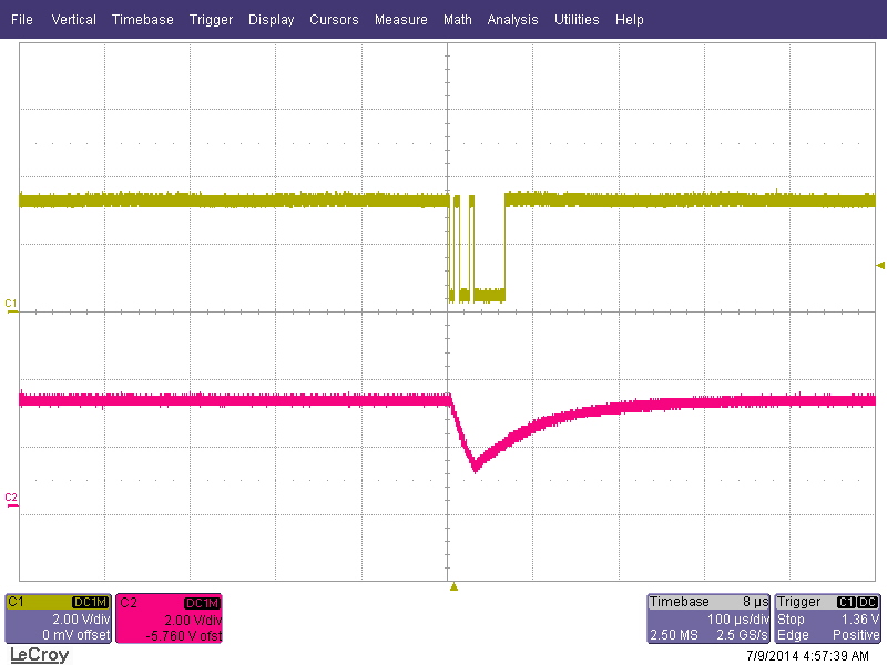

    SCL and SDA line are pulled high  but now I see in oscilloscope that SCL line , clock is not properly generated. while in SDA line, I can see the data from the wave on SDA line.

    The wave form in SDA line is proper but SCL line is weird.
    Please suggest.
  • Hello Sanchit,
    Please note that SCL will have the "Shark Fin" waveform due to Pull Up when sending 1 and drive when sending 0.
    Put a snapshot from the scope, so that we can see if the weird is indeed "Shark Fin" Pattern.
    Amit

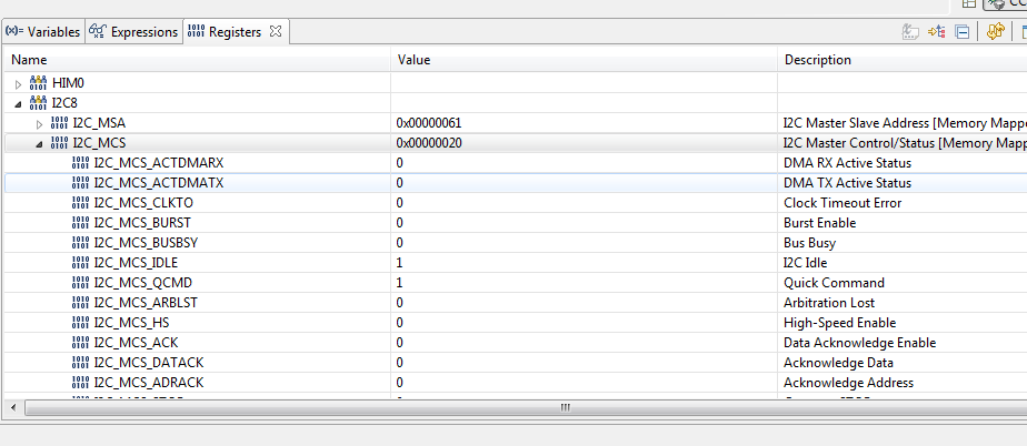

  • Hi Amit,
    pls find atatched the snapshot of the waveform.
    Red Clr is SCL line
    Yellow clr is SDA line waveform.
    and also attached the register status during this state.
    Sanchit
  • Hello Sanchit,
    The SCL is clearly "weird". Is this with the Internal Pull Up? Can you add an external pull up on the SCL of ~4.7K
    Looking at the SCL line it seems there is a very large capacitive load.
    Amit
  • Hello Amit,
    There is one capacitance of 100n on the SCL line .
    I will remove it and try ,

    Why did you put a 100nF cap on the SCL Line?
    The system clock is used to derive the I2C Clock using the I2CMTPR register. We have the 120Mhz waveform. Can you send the 100MHz waveform?
    Amit
  • Hello Amit,
    As this pin was not solely being used for IIC only, there were other purposes to be met out.So this much capicitance was put.

  • Hello Sanchit,
    The Slew rate and drive  will only affect the low level. The High level is due to the Pull Up charging a cap. You have remove the cap.
    First get a basic transfer working before we go to multiple bytes. Without the SCL it would be useless exercise.
