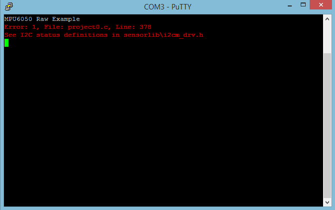

  • I found that my program stops here
    // Initialize I2C3 peripheral.
    I2CMInit(&g_sI2CInst, I2C3_BASE, INT_I2C3, 0xff, 0xff,
    ROM_SysCtlClockGet());
    // Initialize the MPU6050 Driver, preparing it for operation.
    MPU6050Init(&g_sMPU6050Inst, &g_sI2CInst, MPU6050_I2C_ADDRESS,
    MPU6050AppCallback, &g_sMPU6050Inst);
    // Wait for transaction to complete
    MPU6050AppI2CWait(__FILE__, __LINE__);
    I want to ask questions here!

    Why do we pass the MPU6050AppCallback to the MPU6050Init() without any parameters.
    2. I found that my program never set the g_vui8I2CDoneFlag = 1; in the MPU6050AppI2CWait
    void
    MPU6050AppI2CWait(char *pcFilename, uint_fast32_t ui32Line)
    // Put the processor to sleep while we wait for the I2C driver to
    // indicate that the transaction is complete.
    while((g_vui8I2CDoneFlag == 0) && (g_vui8ErrorFlag == 0))
    // Do Nothing
    // If an error occurred call the error handler immediately.
    if(g_vui8ErrorFlag)
    MPU6050AppErrorHandler(pcFilename, ui32Line);
    // clear the data flag for next use.
    g_vui8I2CDoneFlag = 0;
    Therefore my program get stuck in this MPU6050AppI2CWait() function?
    Thanks!

    But the function MPU6050Init() call MPUAPPCallback without any parameters. and the datasheet of the sensor says that g_sMPU6050Inst is a pointer that is passed to the callback function. How do we know which variable will be passed to call back function?
    2. According to the datasheet:
    MPU6050Init Returns 1 if the MPU6050 driver was successfully initialized and 0 if it was not.
    I debug and see that the function does return 1. But after that, the program gets stuck here!
        MPU9150AppI2CWait(__FILE__, __LINE__);
    void
            // Do Nothing
        if(g_vui8ErrorFlag)
    g_vui8I2CDoneFlag = 0 and g_vui8ErrorFlag = 1. I dont know the reason why?
    Hope everybody will help me soon. I going to miss the deadline for this project!
    Maybe, because you are using the wrong C API. I think this should be MPU6050AppI2CWait().
    If you have fixed that, the next problem would be if you are really able to communicate with MPU6050 through I2C.
    Post a schematic showing the circuitry of MPU6050 to Tiva kit, for review.
    - kel
  • Sorry! I did use the
    in my code
    Do you have any other idea?
  • As the previous poster has stated.  The next step is to get a logic analyzer and see what is physically happening on the I2C bus.  Saleae makes an excellent low cost ($149) device that I use.
    Dexter
