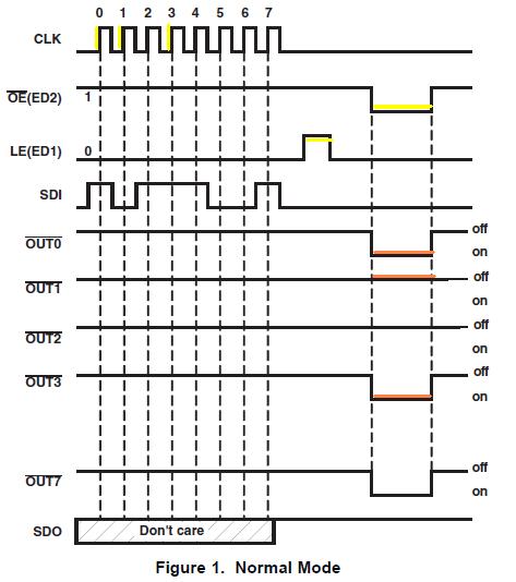

    To aid you and (the always) interested others - here's the timing chart - your 5916 SPI-Led Driver device:
    As strong (devout) believer in KISS - I've (of course) chosen, "Normal Mode" as it's simplest/fastest to bring to life...  Note the addition of color to this diagram - I've highlighted the (most) critical signals.  Key points follow:
    a) Data is initially presented (via SDI) and clocked in via "CLK's" rising edge.  (yellow highlight)  Your choice of MCU's SPI, "format/mode" must insure that the SPI data emitted by the MCU is valid upon such clock rising edge.
    b) After all 8 data bits have been clocked in - you pulse LE briefly high - then return LE low. (another yellow)  That low going edge "latches in" the (most recent) SDI data. One suspects that "old" data remains resident - until that LE action.
    c) Now that (current) data is latched in - we "present it" to the 8 Led Outputs via, "OE driving low."  (yellow highlight)   While OE is high - each/every output w/in 5916 IC remains, "Off."  Note that this 5916 is a current sinking IC - only the Led cathodes are to be (properly) connected & (potentially) driven low - thus illuminating those Leds.   (orange highlight)
    d) Chip data sheet reveals the timing spec/requirement both for LE & OE.  Note that data must first be clocked in - and then LE toggled and only then OE driven low.  Again - 5916 outputs are on/active only while OE is low.
    Via (intuition channel) I hear your/others' question, "Why not tie OE low?"  Indeed that appears possible - drawbacks may include the (unnecessary) viewing of the garbage as the IC updates and the possibility that the chip may actually require that OE toggle for internal, "housekeeping."  (I do not know)
    e) Signals LE & OE would be derived from MCU's non-SPI GPIO - controlled by you - just after the 8 bit SPI transfer completes.  (it may be possible to invert the SPI_FSS signal (which normally goes low when SPI is active) and feed that to OE.  Such would "automatically" enable your 5916 outputs when SPI transactions complete - and blank the outputs as data, "rattles thru the 5916 shift registers."
    For simplicity/testing - unless the IC requires "real toggle" @ OE - one suspects that you can tie OE to ground - just "blip" LE post SPI transfer - and observe Led response.  (to my mind - that should be, "Good for (re-distributive) Gov't Work.")
    It may be possible to provide PWM at/beyond 100Hz to provide an alternate or extended, "Led dimming" function - when introduced upon that OE pin.  Again - that's SWAG "pseudo theory" - if of interest you must experiment.
  • so was able to figure it out tying oe to ground and using motorola mode 0 for clocking. it seems at the low clock rate im using oe isnt really required. thanks for all the amazing work. btw the end application is actually a 2d led matrix.
