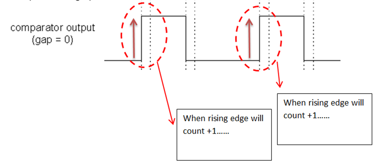

HI,
i have problem with counter.......the result shows keep decreasing value.....
Can someone help me to check what is my problem ?
Description:
When comparator output rising edge then counter will +1.....

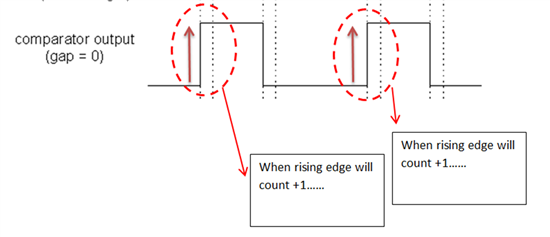

  • Hi!
    I'm currently working on a simple frequency counter which should count positive edges. The time gate signal is coming from an external device and triggers a gpio interrupt which is just working fine. The external edges are produced by the Comparator.
    I configured timer #2 as an input edge counter. Can someone help me to check what is my problem ?
    What should i do if i want to show my output is keep increasing?Example:1...2...3....4....5...6...
    Currently my output is showing 0...1.....0...1...

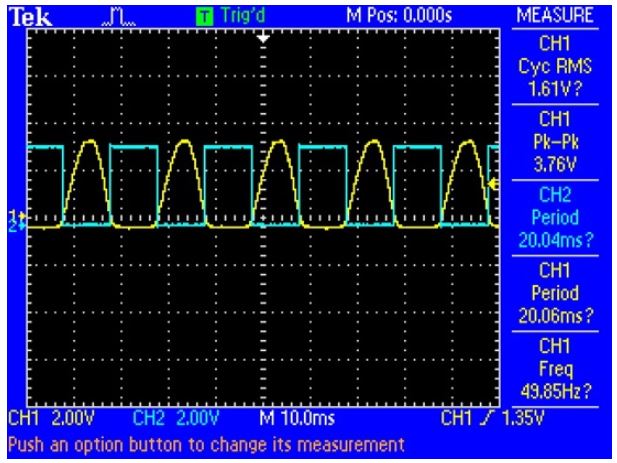

  • Hi Amit,
    My input edge is from the edges are produced by the comparator (from AC plug through a step down transformer then use the voltage divider into 2.33v supply into Co-)
    Dorene
  • Hello Dorene,
    For a 50/60Hz input signal the counter should not be changing so fast. Did you check that the comparator output is clean and does not have spurious edges?
    Amit

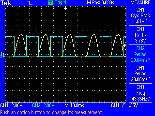

  • Hi Amit,
    i think is clean ....here is my output result.....
    Dorene
  • Hello Dorene,
    The signal being clean will be seen under high resolution at the edge. At 10ms per division, small spikes of few us or ns may not be resolved with a scope. You will have to move the resolution to a better one and then capture it;
    I have just done the timer configuration in tm4c129 devices with a very clean 50Hz square wave and it counts just the way it should.
    Alternatively, if there is a noisy edge and since you want to capture it cleanly without external filter, you can use the GPIO Rising Edge Capture, and put a delay of few 10s of us to count the edge before clearing the Rising Edge Interrupt. Of course it will involve CPU going to the Interrupt Handler at every rising edge, but I would believe that it would be a much simpler approach.
