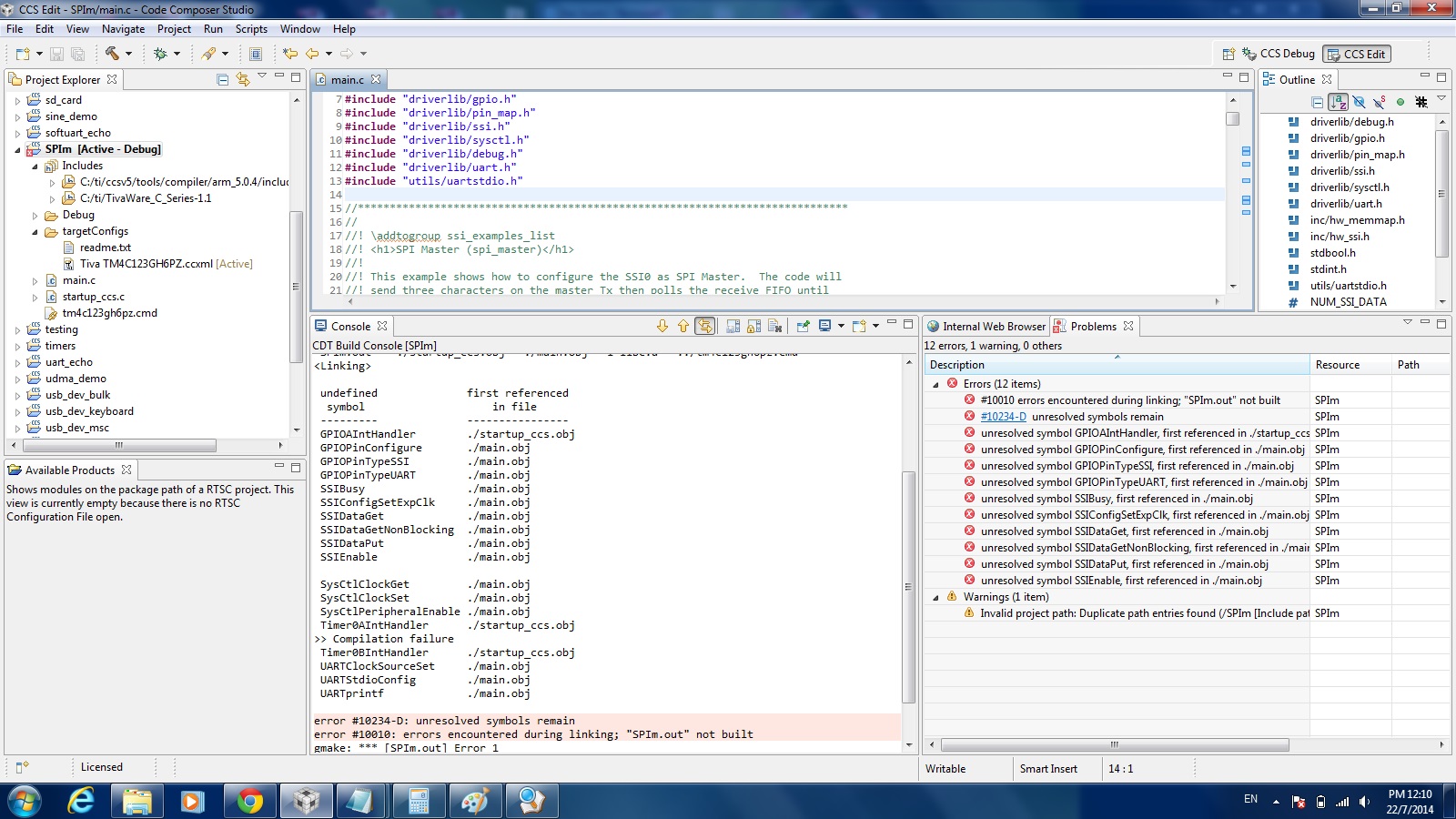

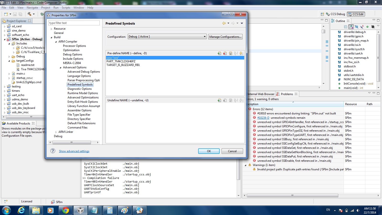

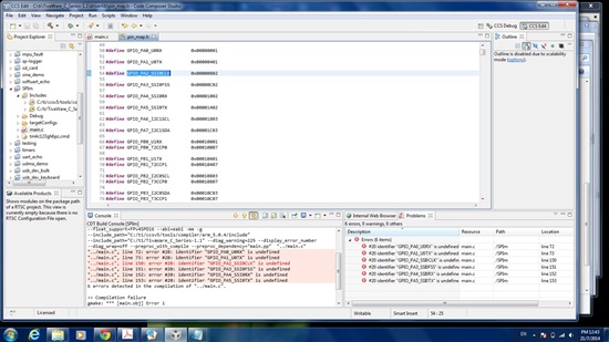

    The Error message picture as below, after build project.
    But the header file already contains them.
    What things I'm missing?
    Lung Tat Ng
  • Hi Amit,
    It is passed if adding "MAP_" in the front of command
    MAP_GPIOPinConfigure(GPIO_PD0_SSI1CLK);
    I find that "MAP_***" is macro expansion, what mean is it if no "MAP_" in front
    Lung Tat Ng
  • Hello Lung Tat Ng
    Did you add the pin_map.h file to the include. The Error means that either that is missing or the Define PART_TM4C123GH6PM is missing in the pre-processor define of the build settings,
    Amit

    Talking above example,  without "MAP_" prefix, "undefined symbol" appear when <Linking> is running.
    My "include setting" is as below picture
    And I also set "Predefined symbols" is as below
    I don't understand why CCS cannot find those symbols.
    The example project is attached as below.
    1376.SPIm.rar
    Thanks and regards,
    Lung Tat Ng
  • Hello Lung Tat,
    I resolved the issues as followes
    1. I updated the TIVAWare version to 2.1.0-12573 as I do not have TIVWare 1.1 version
    2. The driverlib.lib mapping was missing in the Linker Options
    3. The uartstdio.c and .h from utils was missing for UARTStdioConfig function
    4. The GPIOAIntHandler, Timer0AIntHandler and Timer0BIntHandler were not defined any where but were being used in the startup_ccs.c. So I have replaced them with IntDefaultHandler
    http://e2e.ti.com/cfs-file.ashx/__key/communityserver-discussions-components-files/908/6131.SPIm.7z
    Amit

    What is missing is the following in Linker
    Amit
  • Hi Amit,
    I've tried yet, version 1.1 can not add any folder in this manual.
    Do you have any idea to solve it except update version.
    Thanks and regards,
    Lung Tat Ng
  • Hello Lung Tat,
    It is not a folder but a file that needs to be added. replace the driverlib.lib with the equivalent driverlib.lib in the same path for TIVAWare 1.1
    Amit
  • Hi Amit,
    The "undefined symbol" spent my long time. These problems almost solved after install TivaWare 2.1.0..
