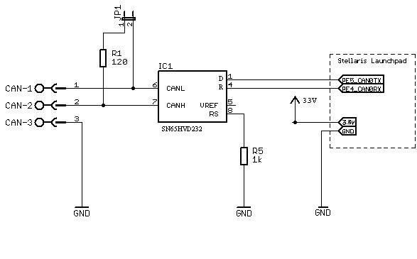

Hi
I am using the simple_tx code provided in the LM4F232 evaluation kit for testing the CAN functionality of the board. I am using the graphics display for debugging. I am using port E pins 4 and 5 for CAN0 functionality. i have also added the CANIntHandler in the startup code. i am getting the following errors in the CAN interrupt handler
(i have used #1 and #2 to indicate the error code location)
- #1 = 0x8000
-#2 = 0x63
and it doesnt come out of the interrupt.
i have interconnected the pins 4 and 5 using a wire.
when the wire is shaken #2 becomes 0xe2 and comes out of the interrupt.
Kindly help me understand what i am doing wrong with this setup.
Thank you
Richin Johns

GPIOPinConfigure(GPIO_PE4_CAN0RX);
GPIOPinConfigure(GPIO_PE5_CAN0TX);
// Enable the alternate function on the GPIO pins. The above step selects
// which alternate function is available. This step actually enables the
// alternate function instead of GPIO for these pins.
// TODO: change this to match the port/pin you are using
GPIOPinTypeCAN(GPIO_PORTE_BASE, GPIO_PIN_4 | GPIO_PIN_5);

CANBitRateSet(CAN0_BASE, SysCtlClockGet(), 500000);
// Enable interrupts on the CAN peripheral. This example uses static
// allocation of interrupt handlers which means the name of the handler
// is in the vector table of startup code. If you want to use dynamic
// allocation of the vector table, then you must also call CANIntRegister()
// here.
//CANIntRegister(CAN0_BASE, CANIntHandler); // if using dynamic vectors//?
CANIntEnable(CAN0_BASE, CAN_INT_MASTER | CAN_INT_ERROR | CAN_INT_STATUS);
// Enable the CAN interrupt on the processor (NVIC).
IntEnable(INT_CAN0);
// Enable the CAN for operation.
CANEnable(CAN0_BASE);
