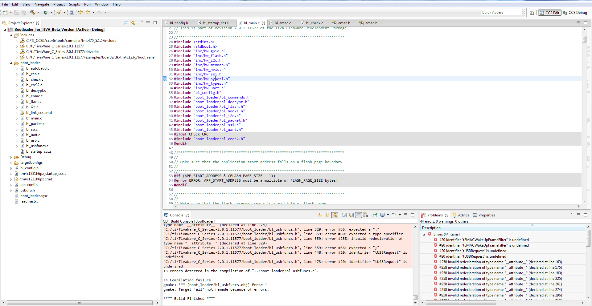

  • Hi Amit,
    Changes i made:
    Changed the controller to   TM4C1231H6PZ
    and i created a Bootloader project in my drive and copied the bootloader folder to my Bootloader Project and included  in ARM Compiler Include Options
    "C:\ti\TivaWare_C_Series-2.0.1.11577\examples\boards\dk-tm4c123g\boot_serial"
    "C:\ti\TivaWare_C_Series-2.0.1.11577"
    "C:\TI_CCS6\ccsv6\tools\compiler\tms470_5.1.5\include"
    "C:\ti\TivaWare_C_Series-2.0.1.11577\driverlib"
    below is my project screenshot

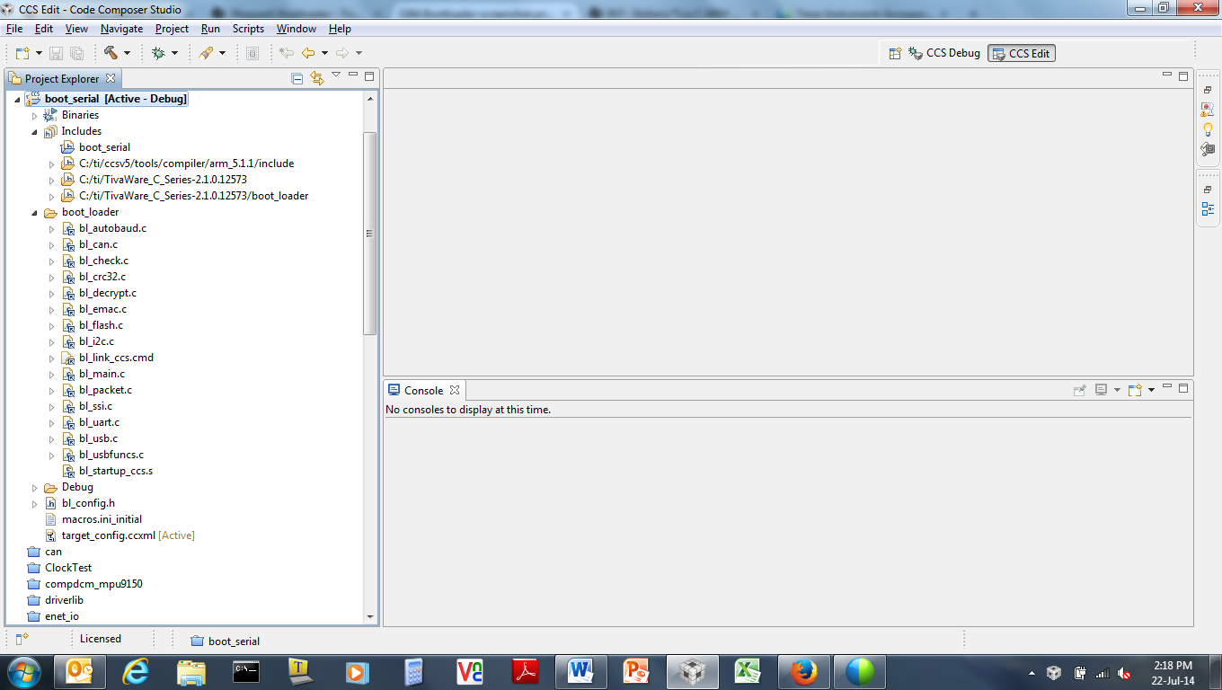

  • Hello Ramesh
    When I imported the project it looks like the following screenshot. It clearly does not have files that are there in your screenshot. I would ask you to delete it from the Workspace and just do a simple import of boot_serial
    Amit
  • Hi Amit,
    Yes you  are correct.
    my mistake was instead of importing i have created another project and added the boot_loader folder to it.
