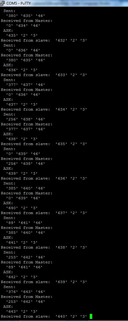

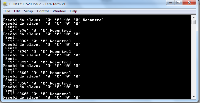

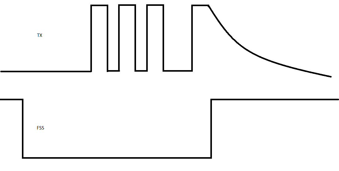

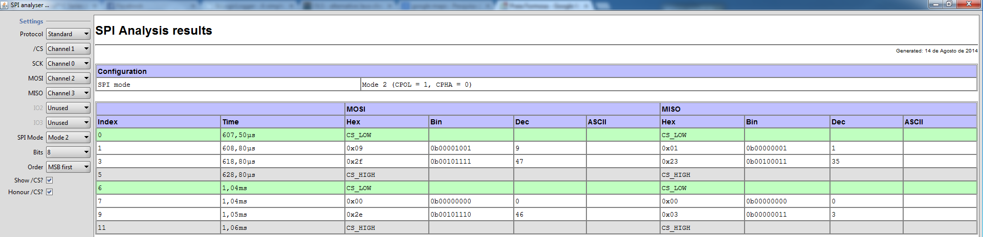

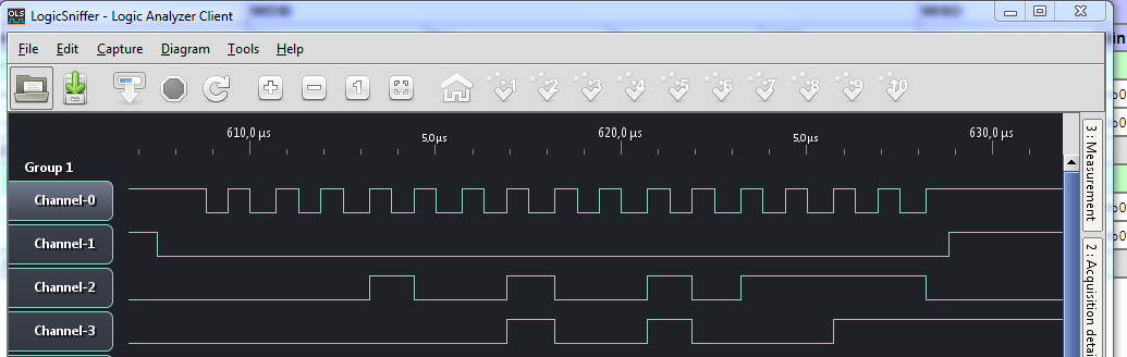

Greetings, im using a TM4C123GXL launchpad and the problem is the next.
Im trying to use the RXFF and TXFF interrupts to send and receive, but one of them is not executing very well,  It can't identify the interrupt.
ulStatus doesn't get in the 0x04 (RXFF). I can't find the problem, it can't execute the interruption for RXFF. probably i dont undertand how it starts this interrupt.

  • Here's the result.
    Send: Master sending to slave.
    Received from Master: Slave receiving.
    Ask: Master asking data from slave.
    Received from slave: Master received data
    Nitice that, data send to slave is 1 cycle of delay (second number).  and the ask is 3 cycles late (first number e other counter).
    I can't supply that time graph or at least i dont now how.

  • Recebi do slave = Received from slave
    Enviei = Sended
    Left values are the Master and Right one slave.
    This is the code with only the communication.
    It triggers twice. Because im using the Dataput commands, and it triggers an interrupt and when it find info, triggers again with the dataget.
    im gonna test my main code adding sme delays and check if its ok.
  • Hello Victor,
    I sure am not getting the data in the format that is shown. In fact for the Master and Slave it prints almost 6 strings. Are you sure that you have sent the correct files? Also I just have connected the SSI lines, Start the Slave first and then start the master. Is the sequence and connection right?
    Amit

  • Greetings,
    I've seen the communication with the osciloscope, the FSS and TX and i noticed something good and something strange.
    The communication is happening when CS is low, but after it gets to its HIGH level, the transmission channel have a behaviour like a discharge capacitor, like in the next image:
    I suppose its not normal.
  • Hello Victor,
    This is fine as there is no clock edge when the discharge behavior happens. The diagram shows only CS and TX, but having the clock will reveal that the sampling clock is not toggling anymore.
    Amit
  • I used the SLLogicLogger with a Stellaris, and i got this result:
    The second image i dont know if its usefull, but it seem's all alright in the communication.
    CH0 - PA2
    CH1 - PA3
    CH2 - PA4
    CH3 - PA5
    MAster channel, mode 2
  • Hello Victor,
    A logic analyzer will show the transition based on what voltage level has been configured to distinguish between 1 and 0. From SSI Communication perspective it is OK for the discharge and would not affect the protocol.
    Amit
