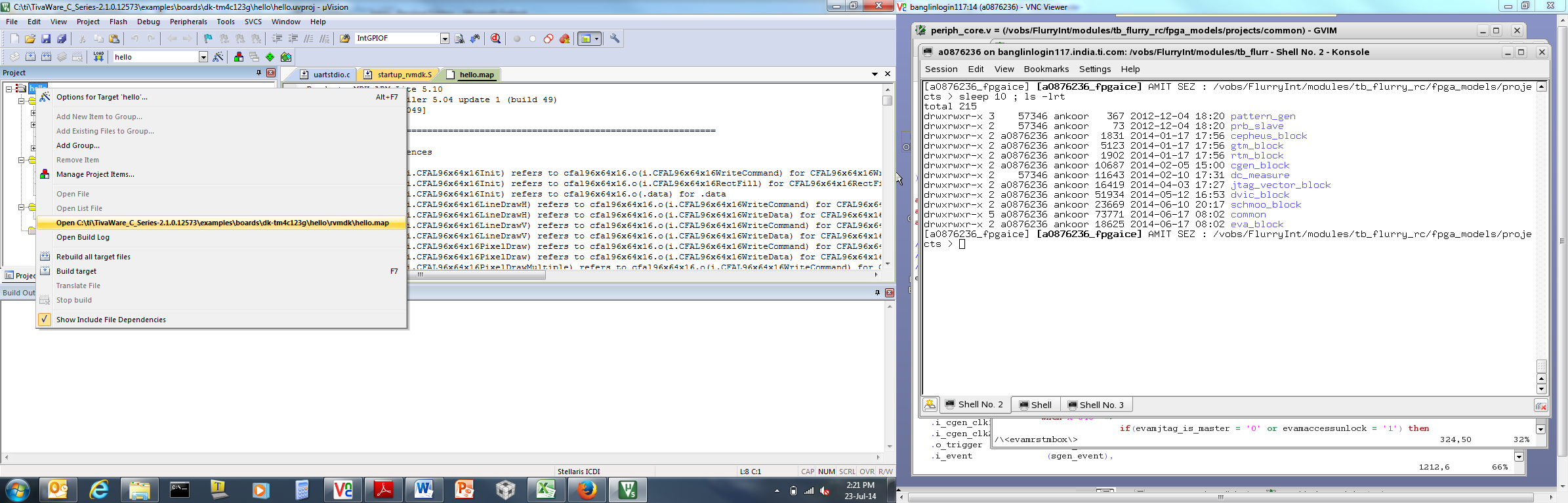

  • Hello Srini
    Keil has the map file. See attached screenshot
    Amit
