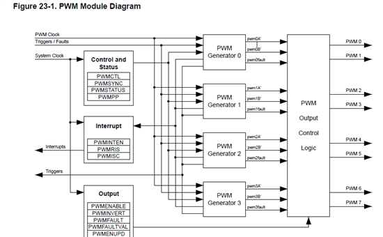

Hello!
I'm working with the EK-TM4C1294XL Launchpad and trying to figure out how to use the hardware PWM module.
Ideally I'd like to find a way to use it in energia, but my guess is that energia doesn't support chip specific features like that, sadly. So any help getting it set up in CCS 6 would be fantastic.
So far I've made a new project and tried to compile the tivaware pwm example "dead_band.c" with an added #define PART_TM4C1294NCPD
Code I've tried is copied here:

But that generates the error:
"../main.c", line 98: error #20: identifier "GPIO_PA0_U0RX" is undefined
"../main.c", line 99: error #20: identifier "GPIO_PA1_U0TX" is undefined
"../main.c", line 214: error #20: identifier "GPIO_PB6_M0PWM0" is undefined
"../main.c", line 215: error #20: identifier "GPIO_PB7_M0PWM1" is undefined
I am betting I have the define incorrect or something, since I assume the example is meant to be easy to use, but I'm stuck and would really appreciate some help here.
Thank you!
Garrett
  • Hello Garrett,
    The define is PART_TM4C1294NCPDT and has to be defined under settings
    Right Click the Project -> Show Build Settings -> Build -> ARM Compiler -> Advanced Settings -> Predefined Symbols

    Do i have always to set pin muxing with the direct access register? In the TI workshop that i liked it is never needed.
    I am unable to set any port besides the PF_0, PF_1 and PF_2 with PWM. I used the code you provided and comented out the pin unlocking
  • Hello Luis,
    Every module which has a IO connection has limited pin muxing options. For the modules which have a single Pin available for the function, you need to set the Port Control, since it still has GPIO function associated to it.
    PWM from generator 0 is available on PF0 and PF1. Each generator has two comparators. Comparator A output is the even number pin and comparator B output is the odd number pin
    Amit
