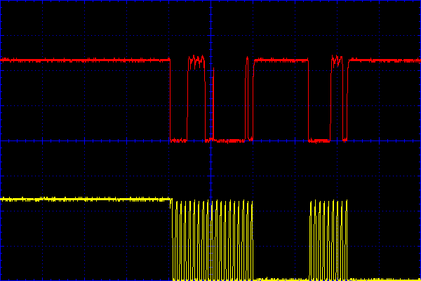

I have some problem to bring the I2C-Master to work.
My setup:
TivaLaunchpad (I2C-Master)
custom Board with MSP430Gx-Controller (I2C-Slave)
Debugging in CCS with full licence
I2C-pullup with around 4kOhm i think
I2c-clock at 100Kb/s
Below is the program. I will give a short description. The I2C-Master should send the address and 3 data bytes. When i run the program like it is i get the following picture at my oscilloscope:
Here you can see that the address will be sent out and the ACK is set correctly. But the next and only byte is the last one with 0x55. This should be the third byte. The data bytes one and two are missing. Why do this happen? I can´t explain that.
But i tried some more things and all things i have done confused me more and more. Here my other tries with pictures.

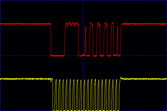

Try 1:
- set a breakpoint to the command data put (it´s the second byte)
- program run into the breakpoint and as you can see the address and the first data byte is sent out correctly
- let the program move on
- this is the second data byte and it looks fine
- after this the program will stick in the while loop for waiting of the clearance of the busy byte forever; just a reset helps

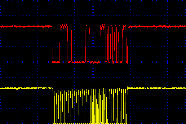

Try 2:
- add a 5000 cycle delay between first data byte and second data byte
- without a breakpoint this will stick in the busy-loop forever

  • Michael Wiesent said:
    //Configure SDA and SCL GPIOPinConfigure(0x00041003); GPIOPinConfigure(0x00041403);
    The defines for that are at pin_map.h
    #define GPIO_PE4_I2C2SCL        0x00041003
    #define GPIO_PE5_I2C2SDA        0x00041403
    Also, I noticed at your interrupt handler iicInt, you did not clear interrupt flag.

  • While there are, "lots of posts dealing w/I2C" (i.e. "Go Hunt") I see this: (note: we use LX4F as master, multiple I2C slaves)
    while(I2CMasterBusBusy()
    Our code is near identical to yours - yet runs/works - and we use  "while(I2CMasterBusy()"  instead of BusBusy!
    I'm unsure if both of your MCUs must operate & exchange in, "Master-Master" mode.  If that's not the case - may be worthwhile to , "KILL that Bus!"

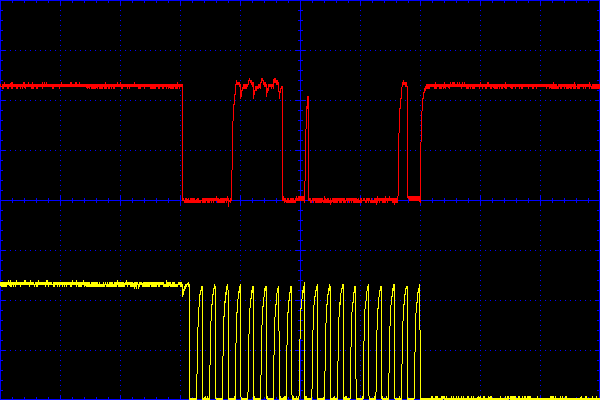

  • That´s the solution. This three letters cost me several hours of my lifetime.
    Thank you for this information. Now the signals are as expected.
