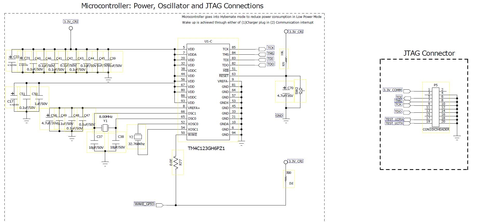

  • Dear Amit,
    1. I checked reset pin is high.
    2. and VDDC Voltage is 1.2 V
    3. How to set 1MHz in JTAG TCK pin?
    and here i am attaching the schematic diagram for your reference.
    Yuvaraj N
  • Hello Yuvaraj
    The schematic speaks otherwise. Notice that the VDDC, VDD and VDDA all are shorted.
    Only VDD and VDDA should be shorted together and connected to 3.3V
    The VDDC must and I repeat "must" only be connected to decap as it is a output of the device.

  • Dear Amit,
                   Sorry Amit i send a old schematic to you. That schematic is mistake one. we already removed the VDDC from shorted connection. we are getting 1.2 V in VDDC.
                   For your information, Previously we used TM4C123GH6PZ1 controller. That time while loading a code, it gives target is not deducted. so we taught controller may gone.
                    We have another controller TM4C123GH6PZT, so we change the controller in that board but now we are getting Load program error.
                    is there any different setting in this controller?
    Yuvaraj N
  • Hello Yuvaraj,
    New schematics please!!! Also do note that the JTAG lines in this case do not have the Pull Up's (which a lot of times have been the cause for failure to connect).
    TCK: Since you are using CCS, double click the ccxml file for the project, goto Adavanced Tab and select the Leaf of the hierarchy "CORTEX_M4_0". You would see the TCK frequency mentioned.
    Do check that the 8MHz crystal is well soldered down.
    Amit

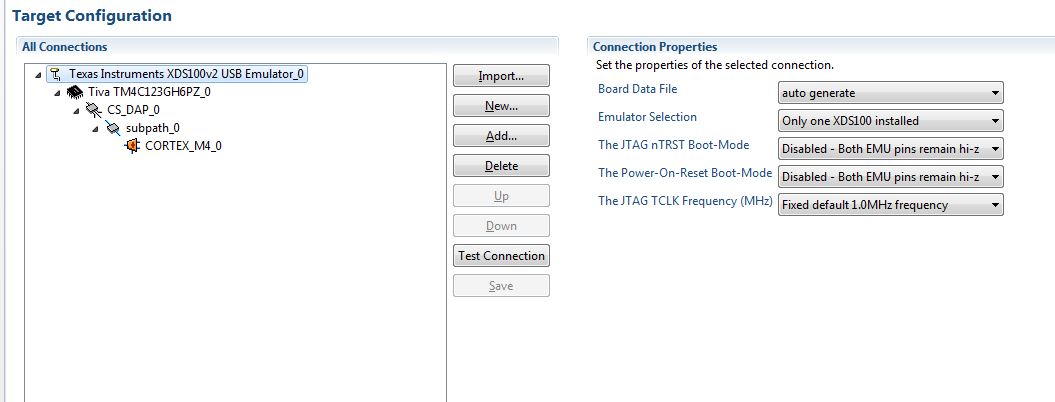

  • Dear Amit,
     plz check the below mentioned schematic.
    1. Now i tried with Pull up in all JTAG pin. Still i am getting the same error.
    2. and i checked the TCK frequency its is 1MHz only. Plz check the below mentioned image for your reference.
    Yuvaraj N
  • Hello Yuvraj,
    What is VDDC Connected to? The schematic shows it to be open pins.
    Please note that the data sheet mandates decoupling cap from 2.5uF to 4.0uF
    Amit
  • Dear Amit,
                We forgot to connect decoupling caps at VDDC. till this time those pins are flotting. now we have connected those decoupling caps and we are seeing that code is dumping properly.
    Thanks for your support. we really appreciate your patience and concern.
