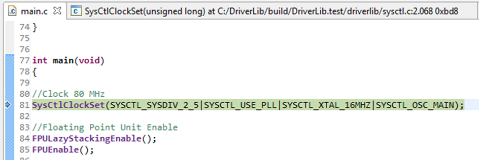

I am doing an ADC Timer Interrupt program which includes a few functions. When I try to examine the program with Step Into, the program performs the step only the first time:
But second time, when supposed next step shoud jump to Line 84, the following error appears:
ARM Linker Path is correctly defined and also startup has the definition for ADC Int Handler properly. My code is shown below. Could you please say me if there is something wrong with it, that is causing error to prompt?. Thanks in advance

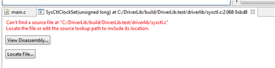

  • Hello Diego,
    The forum has seen this issue quite a few times now. Normally what I do is to add the sysctl.c from the driverlib directory to allow for debug.
    Amit

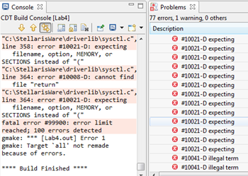

        Add files sysctl.c at your project view under "Source". Build your project and try to step into SysCtlClockSet.
    - kel
  • Hi Amit,
    When I clicket at locate file or also include it in Debug folder:
    Program continues debugging but enter into sysctl.c and starts jumping indefinitely between for and break and don´t gets out anymore:
    I am doing rigth?
    Thanks again.

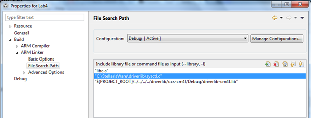

  • Hi Markel,
    Do you refer to: rigth click on Project -  Properties - Build - ARM Linker - File Search Path?. If so, I did so:
    But program can't run given a lot of errors:
    Did you refer to ir or I did it wrong?
    Thank you.

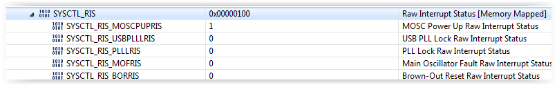

  • Hello Diego,
    That is correct. Can you check if the SYSCTL_RIS register in the memory browser shows that the PLL is locked or not?
    Amit
  • Hi dear Amit,
    I have checked SYSCTL_RIS:
    ulDelay begins to decrease according to for loop:
    And PLL isn't blocked (PLL Lock Raw Interrupt Status is 0):
    So, step into is working fine.
