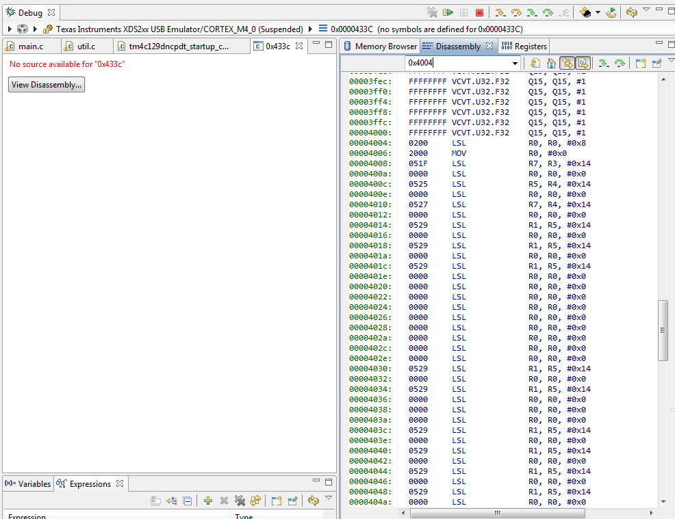

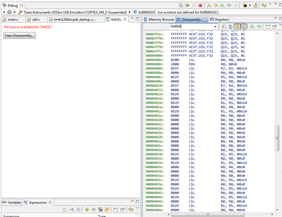

I am using TM4C129DNCPDT board along with XDS200 USB Emulator. I am writing a boot image verfier program which gets executed after the ROM boot loader code. This program after verification jumps to another memoy location in flash memory and tries execute binary of image of my applicaiton present there. I am writing the binary of my application to flash memory using UNIFLASH. I am creatin the binary of my applicaiton by compiling the application project on Code Composer Studio. I am writing this binary at locatoin 0x4004 in flash memory. I am using TIRTOS and tivaware driverlib also.
1)  when i run a debug session on my boot verifier program and jumps on memory location 0x4004, it doesn't show the application code at that location, but it takes a offset of 0x338 locations and shows the application code from location 0x433c.
2) I also tried to debug my application project(from which i created binary of application and written to flash) independently, in that case also the main code looks to start from the 0x338 location which was suppose to start from memory location 0x0. In this case the debugger lands to the location 0x338(where main starts) skipping the previous instructions which also makes sense.
3) As per the map file of the project what i could understand that before actual start of the application code some intvecs and driverlib code gets also written as it gets used in the application code, which also i think makes sense.
But Now what my problem is : When i jump to the location 0x4004 in case 1) above it starts executing the non-application code present at that location and after executing some instructions it goes into FaultIsr function and Hangs up in an infinite loop and my applicaiton code doesn't get executed at all. Instead of jumping on to the location 0x4004 i also tried to jump to
a)  0x420C( 0x4004 + 0x208(as MAP file shows in itial 0x208 location for some intvecs)) and
b)  0x42A8(0x4004 + 0x2a4 (as Map file shows this memory location also before start of main))
But in both of the above cases also the code hangs up in some infinite loop and my application code doesn't get executed at all.
But, if i jump to 0x433c where my application code is present, it works perfectly fine for me. But the problem here is : As here i know that the offset from where i wrote the application binary is 0x338 locations which won't be the case everytime and if there is any upgrade in my boot image it will definitely have some different offset which won't be known to my boot image verifier program. So, in that case the location from where the actual application codeis present will be unknown to my boot image verifier program and i will misbehave.
I am looking for a solution on this problem.
I am attaching the Map file of my sample application code in a text file format. Please find it in the attachments.
Also i am putting below snapshots to get some idea for different scenarios i mentioned above.
1) Address location 0x4004 showing non-application code
2) Location 0x433c showing my applicaiton code present there.
3) When i debug my appllication project code independently, the debugger landing on the main code at location 0x338 as mentioned in above point 2)
Please suggest some solution as this is completely surprising behaviour.
