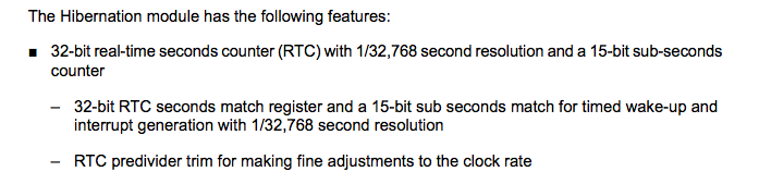

Hello all,
My project requires a real time clock AND sub-seconds event timing. Somewhere in it, I need to create a timestamp that would be like HH:MM:SS.ss - (1/100s resolution is good enough)
I got the RTC of the hibernation module to work just fine.
The HIBERNATE_COUNTER_24HR (Calendar) mode is really convenient to allow for a proper calendar behavior without having to worry with functions that increment seconds, minutes, hours, etc... But such mode does not allow for using the RTCSS value.
So I thought about Calendar mode together with a second timer (TIMER7_A), running from the same clock as the Hibernation module. My event time would be HibernateCalendarGet(&current_time) plus the fraction of the current timer value.
I am however failing to sync both timers. I tried to start the hibernate time, enable a "round second" interrupt and immediately start TIMER7_A, but it won't sync at all (they both loop every second, but I can't get the TIMER7_A to reset at the same instant as the round second (a piece of code below).

Any suggestions for a different approach or to make this one work?
Thanks!
Bruno

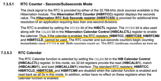

  • I am really lost on this one.
    These two pieces of the datasheet seem to inform that it is NOT POSSIBLE to use the CALENDAR MODE together with the sub-seconds counter. Is that a fact or not?
    If that is indeed the case, then I am seeking help to use the RTC in CALENDAR mode and still be able to keep a sub-seconds count. That is why I thought of using a general purpose timer, and try to start it "together" with the enabling of the RTC.

    You are not completely lost - you may realise that you have two modes available: The Calendar one, and the RTC one, with sub-seconds information. You should also know that the Calendar mode has a small bug inside, year field is not correctly treated (we know where the bug is and how to correct it) but this mode does not use sub-seconds. You may use the RTC with the same results as Calendar by using two routines from Tiva/utils/ustdlib.c, ustdlib.h, namely ulocaltime and umktime - works very well - and just need to add sub-seconds to your data. These are if you need month/year... - your claims in the first post were HH:MM:SS:sSS - if that is the case only, no need of above routines, just dividing the seconds in h/min.. may be an easier alternative.
    I posted an example with only RTC and ulocaltime/umktime, but no sub-seconds, this spring (don't remember when), I will try to search and re-post.
    Petrei

    I agree with Petrei. It would be simpler to read the RTC in normal mode so that you get the count of Seconds and Sub-Seconds and then use the Seconds to display in DD:HH:MM:SS format
    Amit

  • Amit, Petrei,
    I stand defeated. Will revert to RTC normal mode, and simply convert seconds into human time whenever needed. I agree it is an easy math.
    I guess I just wanted to use what sounded like such a nice hardware feature: the calendar mode...
    Anyway, if any of the readers have nothing better to do with their time, the challenge stands: try to use calendar mode and something else to count sub-seconds, properly synced.
    Thanks for the help!!!
    PS: RTC normal mode implemented and working like a charm, thanks! Here's a small piece of code if anyone else needs a hint:
    	current_seconds = HibernateRTCGet();		 // read current RTC counter in seconds
    	secdec = HibernateRTCSSGet() * 100 / 32768;  // secdec is 0.xx seconds
    	ulocaltime(current_seconds, &current_time);  // current_time in tm struc format
