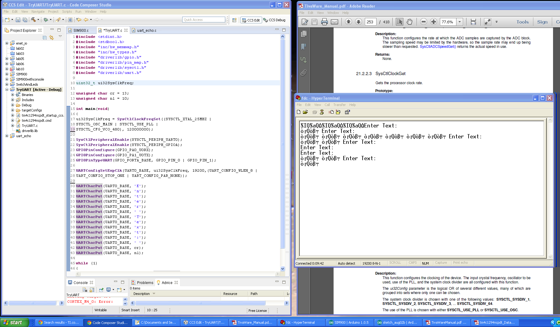

hi, I can get 115200 and 57600 baud rates to work without errors but not with slower rates. I need 19200 to use a SIM900 module. Here is a screen shot:
any help would be great.  thanks, dan

  • yep, i did the same for 9600, 19200, 38400, 57600, and 115200. only the higher ones work.  the only code that i'm changing is in UARTConfigSetExpClk() .  "  Enter Text:   " is  the only thing that should be there.
  • Hi Daniel,
         I think this is related to the Error rate. AFAIK, something like higher system clock with lower baud rate will have higher error rate. Correct me if I am wrong.
         I see you set the system clock at 120MHz and it only works for 115200 and 57600 baud rate. So, try a lower system clock for 19200 baud rate.
        You, can experiment and start from 16MHz, 25MHz, 50Mhz, then 80Mhz system clock. There are other system clock settings, these are the ones that I currently remember.

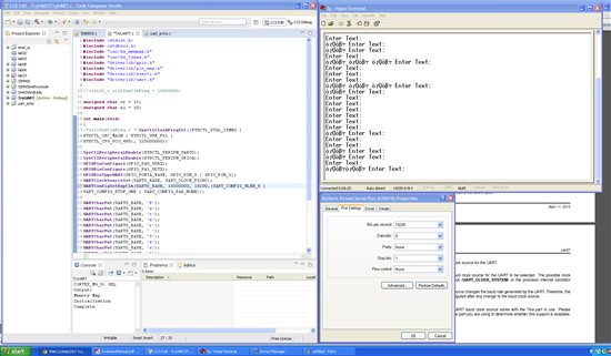

  • hey,
    I downloaded and installed teraterm. I'm getting the same number of errors as HyperTerminal at 9600 and 19200. just as  you thought. Changing the clock source did get 38400 to work without errors. getting closer.

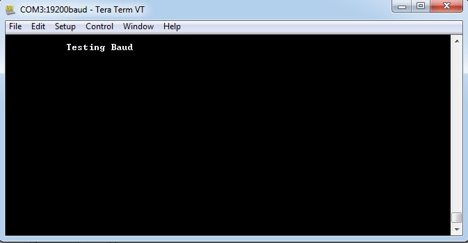

  • Hi All,
        I have confirmed that 19200 UART Baud Rate works with lower UART Clock Source Value.  Also, even if you set the UART clock source as PIOSC 16Mhz, if System Clock is high there will be garbled output. The higher the System Clock with low UART Baud rate settings, The higher rate of garble data outputs
        I use the uart_echo example program with this system clock setup and uart clock setup below. I test the output at TeraTerm at each system clock setting at 120Mhz, 60Mhz, 48Mhz, 30Mhz, 24Mhz, 12Mhz and 6 Mhz. I reset the board repeatedly to see if any garbled data would output at TeraTerm.
    g_ui32SysClock = MAP_SysCtlClockFreqSet((SYSCTL_XTAL_25MHZ |
    SYSCTL_OSC_MAIN |
    SYSCTL_USE_PLL |
    SYSCTL_CFG_VCO_480), 48000000);
    ROM_UARTConfigSetExpClk(UART0_BASE, g_ui32SysClock, 19200,
    (UART_CONFIG_WLEN_8 | UART_CONFIG_STOP_ONE |
    UART_CONFIG_PAR_NONE));
    At 120Mhz, 60Mhz, 48Mhz TeraTerm output (Garbled):
    At 30Mhz, 24Mhz, 12Mhz, 6Mhz Tera Term Ouput (No Garble);

    Appears you/I/others may have different sense of, "Garbled."  Your top screen cap shows, "Testing Baud" generated nicely - but then "followed" by 5 (we assume) errant or phantom characters.  I would not classify that as, "Garbled" instead it appears to be unexpected/unwanted "extra" transmission.
    Believe, "Garbled" to be generally agreed to be, "those characters arriving w/no apparent, recognizable consistency."  As your first 12 chars. arrived fine - "garbled" appears not to be the best descriptor...
    If one had to guess - some, "buffer management" issue would rise on my, "suspect list."

        Just to detail, at 60Mhz system clock and 19200 baud rate, these are the exact output response
        After board reset: "Testing Baud"
        After board reset: "garbled output"
        The picture I post here with garbled data is exact output.
        At 120 Mhz system clock and UART clock set to PIOSC and 19200 baud rate
