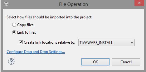

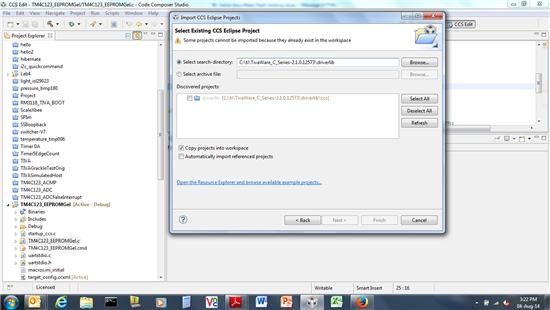

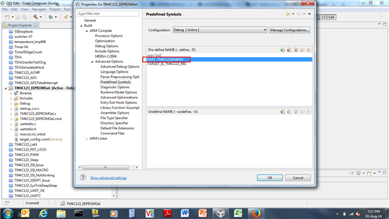

       If you are using the Tiva Launchpad, these defines can be found at pin_map.h and are dependent on a preprocessor symbol. So, set it at your project settings.
       PART_TM4C123GH6PM
    - kel
  • hi Markel
    do you mean the error i have mentioned? or the question i ask?
  • Hello Kelvin,
    What Kel mentioned is shown in the following snapshot
    Amit
  • hi Amit
    thank for the answer problem solved

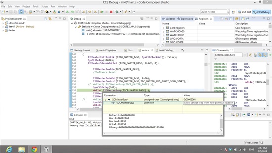

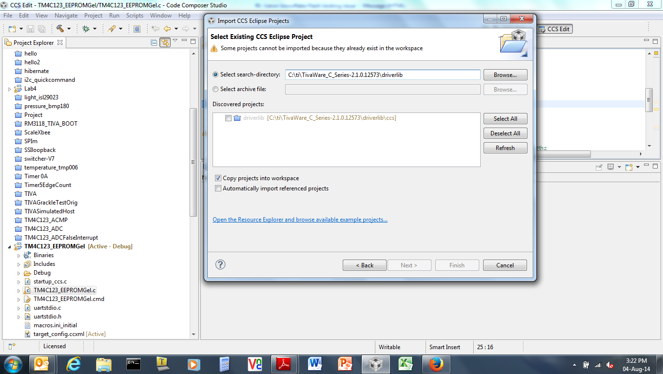

    i have tried to put all the code into the uC , based on what i have sent you, but it does not work as expected, i not sure what happen but when i slowly step over and over again by clicking F5, found that there is a message show
    Can't find a source file at "C:/DriverLib/build/DriverLib.test/driverlib/sysctl.c"
    Locate the file or edit the source lookup path to include its location.
    what is it, is it an error?

    Looking at the error message it seems that it is not able to find the original driverlib.lib for the disassembly. You can import the driverlib.lib as a CCS project, recompile it and then use the resulting lib file in the Linker Path.
    Alternatively you can add sysctl.c to the Locate File Button.
    Amit
  • hi Amit,
    do you mean like doing as same as the above pic?, if yes, i have linked my file into the project location
    the above are my file directory
  • Hello Kelvin,
    Import the driverlib as shown in the Snapshot, compile it and then use the output driverlib.lib which would be created in the workspace
    Amit
  • hi amit
    thank, the error is dissapear, 1 more question,

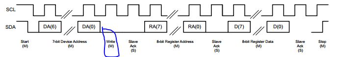

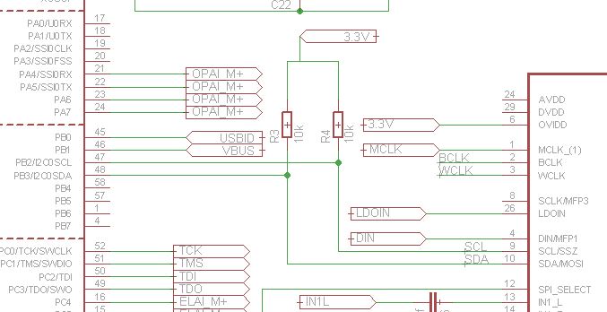

  • i think i have understand on about the explaination included the code. but refer to the one u send me i found that mine have extra component which is write command, since from above code i saw that we only have send and check master busy or not, but there is a write between 1st byte and 2nd byte. is it mean i have to put in an extra command to allow it write. or proceed with the previous way i written.
    thank a lot
  • Hello Kelvin,
    The section of diagram that you have highlighted is centric to any I2C operation. This is done by the API I2CMasterSlaveAddrSet with the third parameter set to false.
    Amit

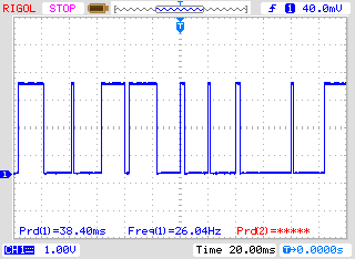

  • hi amit
    i have tried using osc scope, there is a data from SDA line, which mean the data i wanted to have, but just curious to ask, the other devices are non programmable, but need i2c to communicate with it. based on the image bi sent u, do i need to send SCL too for clock?
    each time i try to use the i2c sometime it stuck at command i2cmasterbusy, i have no idea why even with dalay
    there is an error which is cannot load from non-primitive location
    thank
  • Hello Kelvin,
    SCL and SDA are both mandatory for I2C. Can you attach the final code and mark it where it get's stuck?
    Amit

    the one in green comment (line number 156)
  • Hello Kelvin,
    That could be the case if you halted the code in the middle of a transmission that could have caused the Slave to get stuck.
    To ensure that the Master is not stuck, can you add the following code to the PortFunctionInit!!!
    MAP_SysCtlPeripheralEnable(SYSCTL_PERIPH_I2C0);
    with
    MAP_SysCtlPeripheralDisable(SYSCTL_PERIPH_I2C0);
    MAP_SysCtlPeripheralReset(SYSCTL_PERIPH_I2C0);
    Amit
  • hi amit
    i m still stuck at the same line which i have mentioned just now
  • Hello Kelvin,
    The debug cannot happen without knowing what slave device you have. Can you send the datasheet of the slave device,
    Amit
  • hi Amit
    below are data sheet of the devices
    http://www.ti.com/lit/ds/symlink/tlv320aic3204.pdf
    application reference guide
    http://www.ti.com/lit/ml/slaa557/slaa557.pdf
    thank a lot
    Kelvin
  • Hello Kelvin
    The I2C Address of this device is 0x18 and not 0x38. This is very clearly mentioned in the data sheet and application note, unless I am missing something in the documentation
    Amit
  • hi amit
    i think i have mistake as i tot i using the slave address from uC rather than using the slave address from the device as i mentioned above
    i m still having problem of the program still keep looping meaning the i2c master are busy all the time after the 1st byte been sent out
  • Hello Kelvin,
    Can you attach a scope screenshot of what the transaction is looking as?
    Amit
  • hi amit
    below are the scope for SDA, SCL will be zero all the time
    while i connect to the devices, there is noise occur and the i2c signal lost
    when i try using step over in CCS, found that it stuck at i2cMasterbusy
    therefore i have no idea why it stuck at i2cmasterbusy
  • Hello Kelvin
    I2C SCL cannot be 0. Is the Pull Up on SCL and SDA there on your board.
    Amit
  • there is an pull up in other devices, but signal losses when it is connected to other board
  • Hello Kelvin,
    The Pull is needed for the bus to operate. So you should complement the pull up of the devices with an on-board pull up for the bus, so that even if you connect any new device which does not have an internal pull up, the protocol can work properly.
    I hope I am able to explain it well

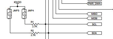

  • hi amit
    below are my own design for i2c
    meanwhile on the other hand using evaluation board for the other devices as following
    where the iovdd is 3.3V
  • Hello Kelvin,
    It is correct: As long when configured for I2C, you see both SCL and SDA during bus idle state.
    In the second snapshot  are the Jumpers mounted and SCL and SDA shown coming from the uC which is somewhere in the schematic. The Pad SCL and SDA shown in the right side of the picture would be some header for other devices?
    Amit
  • the 2nd pic is come from the evaluation board of the devices itself which i have sent u the data sheet and the application note
    i will try a trick which will be doing an external pull up for SDA and SCL
