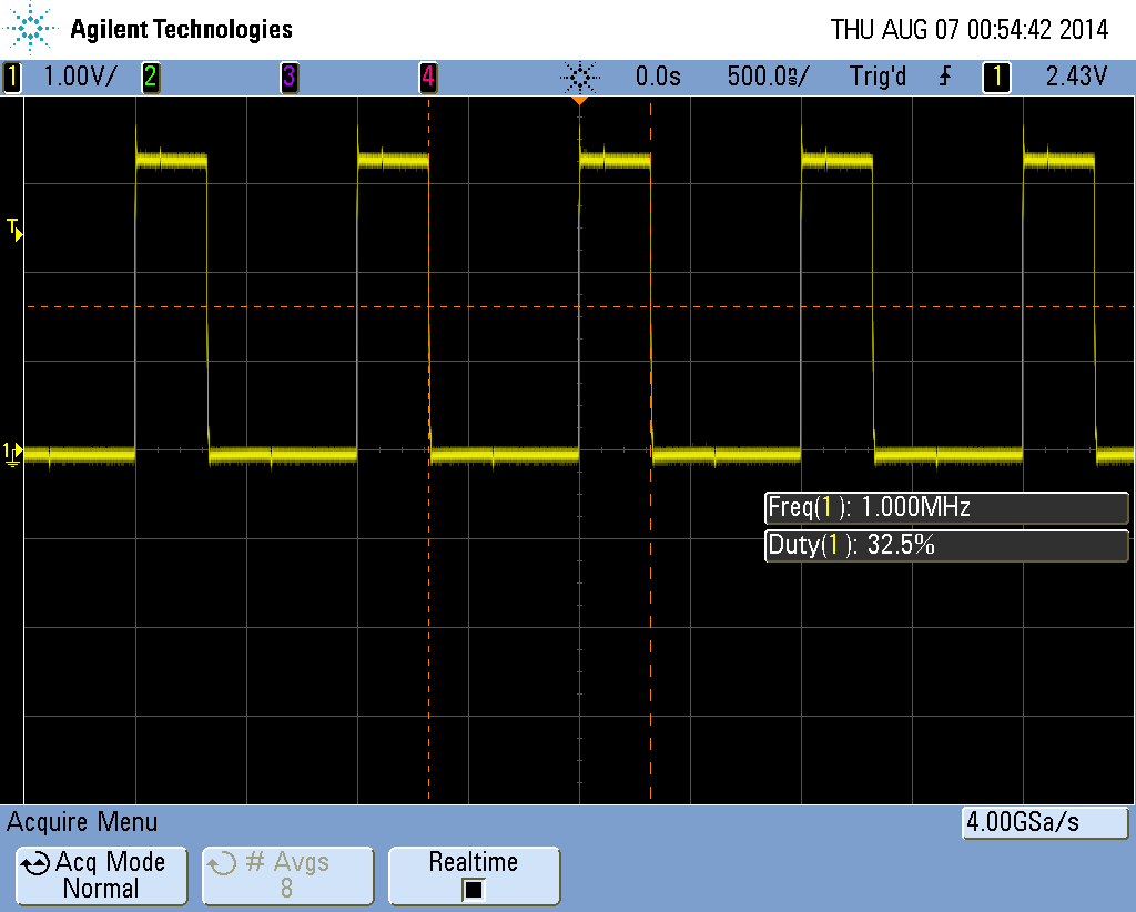

Hii all,
When I am using 80MHz clock , my pwm signal at 1 MHz is distorted. while at system frequency of 40 MHz , it is quite accurate. why??

    for 80 MHz system clock and 1MHz PWM , output waveform is of 1.33 MHz
    But for 40MHz system clock and 1MHz PWM , output waveform is of 1MHz accurate.
  • Hello Prashant,
    First of all there is a coding error. You have mentioned the clock set function as following
    SysCtlClockSet(SYSCTL_SYSDIV_1 | SYSCTL_USE_OSC | SYSCTL_OSC_MAIN | SYSCTL_XTAL_16MHZ); //for 40 MHz
    // SysCtlClockSet(SYSCTL_SYSDIV_1 | SYSCTL_USE_OSC | SYSCTL_OSC_MAIN | SYSCTL_XTAL_16MHZ); //for 80MHz
    When the System Clock is Main Oscillator you cannot get 80MHz or anything above 16Mhz for that matter.
    Secondly, If you are using TIVAWare 2.1.0 then there is a known bug that for 80Mhz the API SysCtlClockGet function will return 66MHz. Instead of using the API return value, you would need to hardcode the value for 80000000.

  • Hello Prashant,
    To get 80MHz clock you would need to use the API as
    SysCtlClockSet(SYSCTL_SYSDIV_2_5 | SYSCTL_USE_PLL| SYSCTL_OSC_MAIN | SYSCTL_XTAL_16MHZ);
    And instead of using the return value of SysCtlClockGet use the fixed value of 80000000 assigned to the variable that was previously getting the value from the SysCtlClockGet API
    Amit

  • Hello Prashant,
    I took the code you had
        unsigned long ulPeriod;
        //Set the clock
        SysCtlClockSet(SYSCTL_SYSDIV_2_5 | SYSCTL_USE_PLL | SYSCTL_OSC_MAIN | SYSCTL_XTAL_16MHZ); //for 80 MHz
        //Configure PWM Clock to match system
        SysCtlPWMClockSet(SYSCTL_PWMDIV_1);
        // Enable the peripherals used by this program.
        SysCtlPeripheralEnable(SYSCTL_PERIPH_GPIOF);
        SysCtlPeripheralEnable(SYSCTL_PERIPH_PWM1); //The Tiva Launchpad has two modules (0 and 1). Module 1 covers the LED pins
        ulPeriod = 80000000 / 1000000; // PWM frequency
        //Configure PF1,PF2,PF3 Pins as PWM
        GPIOPinConfigure(GPIO_PF1_M1PWM5);
        GPIOPinConfigure(GPIO_PF2_M1PWM6);
        GPIOPinConfigure(GPIO_PF3_M1PWM7);
        GPIOPinTypePWM(GPIO_PORTF_BASE, GPIO_PIN_1 | GPIO_PIN_2 | GPIO_PIN_3);
        //Configure PWM Options
        //PWM_GEN_2 Covers M1PWM4 and M1PWM5
        //PWM_GEN_3 Covers M1PWM6 and M1PWM7 See page 207 4/11/13 DriverLib doc
        PWMGenConfigure(PWM1_BASE, PWM_GEN_2, PWM_GEN_MODE_UP_DOWN | PWM_GEN_MODE_NO_SYNC);
        PWMGenConfigure(PWM1_BASE, PWM_GEN_3, PWM_GEN_MODE_UP_DOWN | PWM_GEN_MODE_NO_SYNC);
        //Set the Period (expressed in clock ticks)
        PWMGenPeriodSet(PWM1_BASE, PWM_GEN_2, ulPeriod);
        PWMGenPeriodSet(PWM1_BASE, PWM_GEN_3, ulPeriod);
        //Set PWM duty-50% (Period /2)
        PWMPulseWidthSet(PWM1_BASE, PWM_OUT_5,ulPeriod/(100/30));
        PWMPulseWidthSet(PWM1_BASE, PWM_OUT_6,ulPeriod/2);
        PWMPulseWidthSet(PWM1_BASE, PWM_OUT_7,ulPeriod/2);
        // Enable the PWM generator
        PWMGenEnable(PWM1_BASE, PWM_GEN_2);
        PWMGenEnable(PWM1_BASE, PWM_GEN_3);
        // Turn on the Output pins
        PWMOutputState(PWM1_BASE, PWM_OUT_5_BIT |PWM_OUT_6_BIT|PWM_OUT_7_BIT, true);
        //Do nothing
        while(1)
    And ran it. Attached is the output of PF1. It is a 1MHz 32.5% DC output
