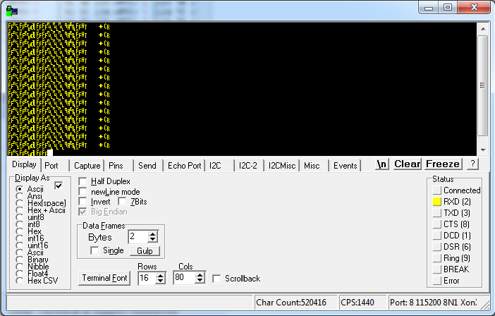

I'm linking up a Spectrum Satellite Receiver to my TM4C123GH6PM board.

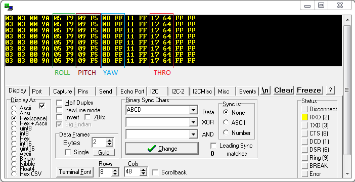

It communicates through UART sending a stream of data as shown bellow:
My goal is to read the 4 sets of hex numbers (Roll, Pitch, Yaw and Thro) and put them in to 4 separate integers.
The stream of data is continuously and always in the same form.

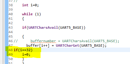

while (1)
int i=0;
buffernumber = UARTCharsAvail(UART5_BASE);
if(i<buffernumber)
buffer[i++] = UARTCharGetNonBlocking(UART5_BASE);
I don't get any readings. I can clearly see data being streamed in the UART5 Registers when online on the board, though my code won't get any through the UART5_BASE.
