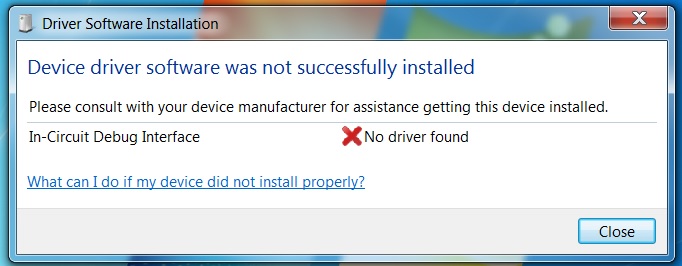

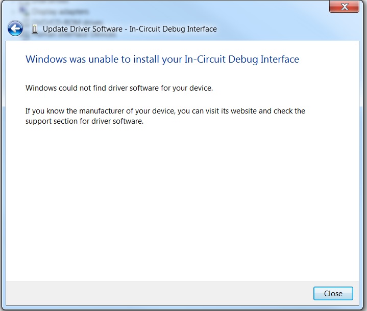

I am unable to install drivers for Tiva C Series Launchpad on Win7 64 bit. Haven't use it for a while (it was all working well before) and in a meantime have a new CCSv6 installed. After searching and trying for about half a day still no luck.
Any hints, please?

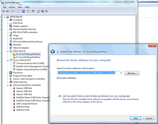

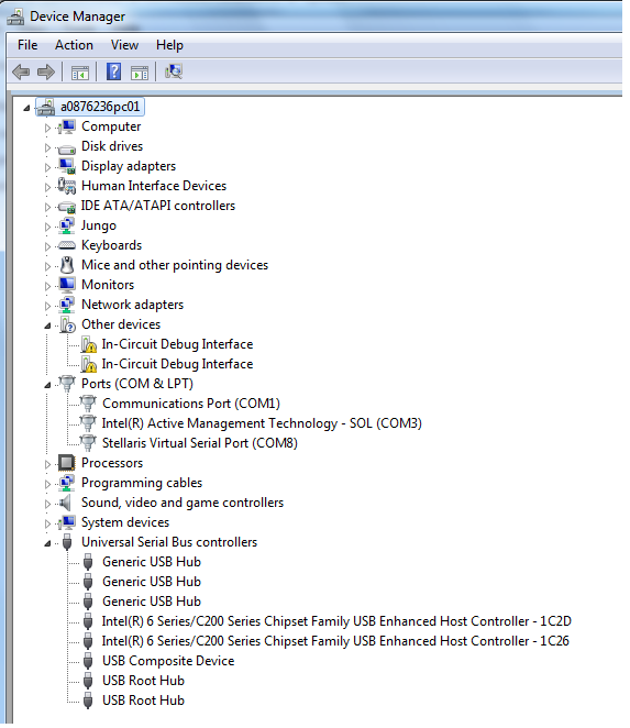

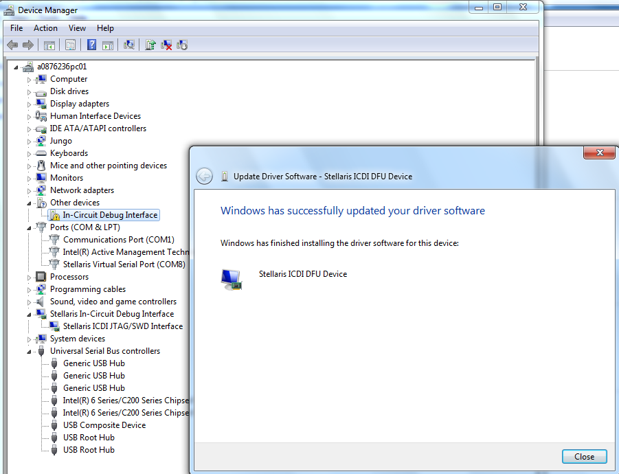

  • Hi Amit,
    Thank you for trying to help me, but still no luck.
    I have a 3 different types of Stellaris/Tiva boards. They were all working previously fine with no driver problems.
    Now the status is:
    1) Tiva C Series TM4C1294 Connected Launchpad - installs easily 3 drivers (Stellaris Virtual ComPort, Stellaris ICDI DFU Device and Stellaris ICDI JTAG/SWD Interface)
    2) LM4F232H5QD Evaluation Board - no drivers
    3) Tiva C Series Launchpad EK-TM4C123GXL - no drivers
    Once again, some time ago I was able to work/program items 2 and 3 on the same PC.

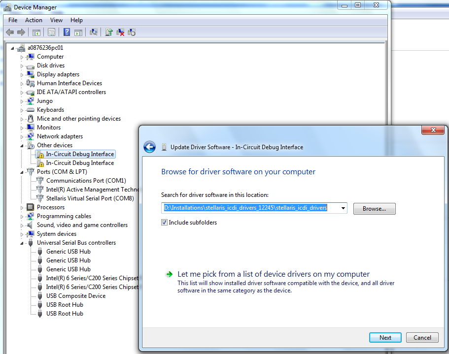

    Following your advice I did an attempt to manually install driver for (3) using the drivers from the link you supplied:
    Any other suggestions?
    Thanks again
    Jan

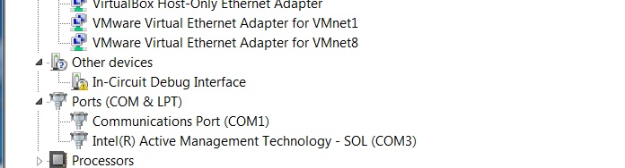

  • Hi Amit,
    The answer is no. We haven't used the boards for about 2 months (inter-semester break). Everything was working fine before, but not now. It looks like after plugging in, the enumeration process brings only one device, which is In-Circuit Debug Interface instead of three different ones.  I'm lost with options now. If you have any suggestions it will be much appreciated.

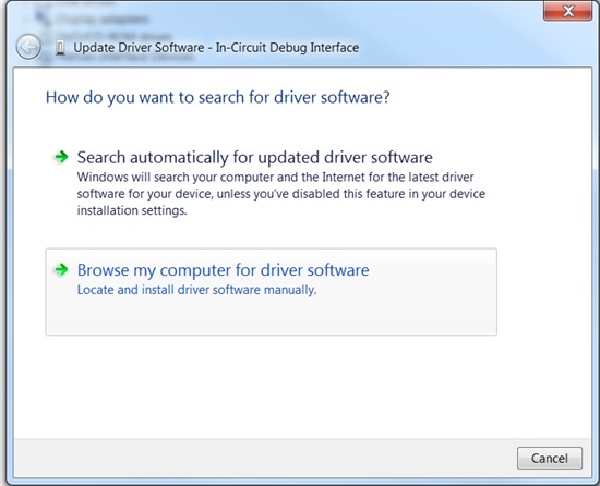

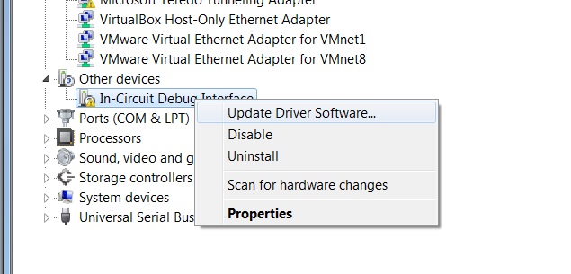

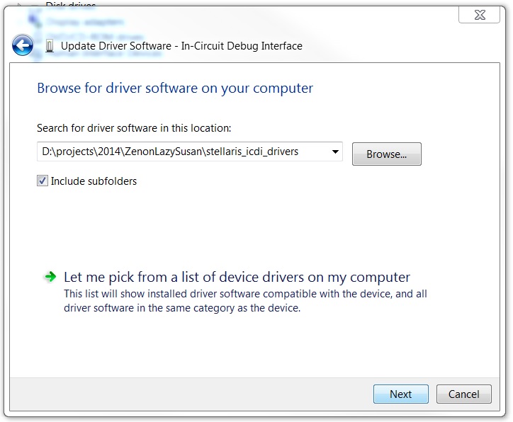

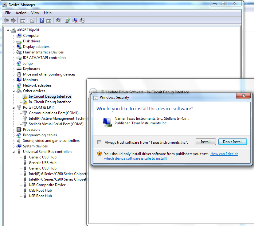

        Some details in this post below might help.
        My Stellaris Launchpad is not recognized by Windows 7 64
    - kel
  • Thanks for that link, it fixes my problem.
    Much appreciate it.
