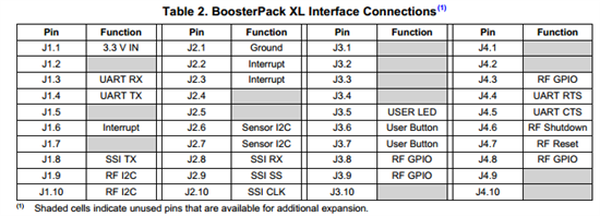

Having some trouble using available pins when my TM4C123GH6PM board has the SensorHub attached to it.
My goal is to use the MPU9150 example and add some code for 4 separate PWM outputs, and a single UART input.
I have to separate problems.
Nr.1: Finding available pins for the 4 separate PWM outputs. Can you help? I still want the MPU9150  working.
From the "BOOSTXL-SENSHUB Sensor Hub BoosterPack - SPMU290 User Manual" i have following available pins (shaded cells):

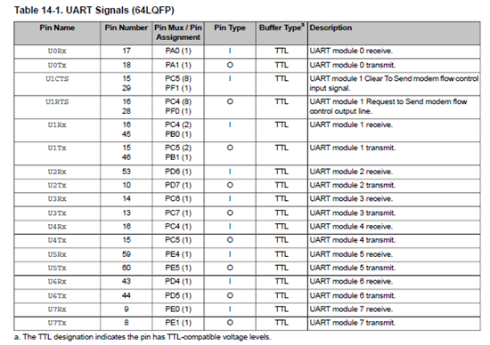

From the tiva datasheet I have following PWM pins:
Nr.2: Have reading problems on my UART5 - U5RX pin. The UART5 receives data to the buffer, though it passes chunks at some time and then no data. The stream should be continuously.
Is there a problem with using U5RX when running the sensorhub and the MPU9150? Do I have a mixup?
Maby I have a mixup on the clockspeeds or something?
Here are all UART pins on the main board:
Here is my sample code (UART code marked in green):

    Problem-1: You can get 4 PWM's but for doing that SW2 user switch on the main board must not be used. Also R8 resistor from TM4C123 launch pad needs to be removed. Is that OK?
    Problem-2: PE5 (UART5 TX) is getting connected to the Light Sensor Interrupt Line. However PE4 which is UART5-RX is not connected and should be OK to receive the data. I do see in the code you are reading the UART data into a buffer. But where is the buffer used?
    Amit
  • Hi Amit,
    Problem-1: I don't need SW2 and can remove the R8. What PWM pins are then available to me?
    Problem-2: Yes, the UART data goes in to the buffer. Using the buffer comes later. Just want my reading working first. Is it okey using UART5-RX for one input, and the UART5-TX transmitting for a completely different (Light sensor)? The won't be a conflict when configuring these two?
  • Hello Alexander
    Problem-1: What I did was I took the Header Pin Configuration of the EK-TM4C123GXL and tallied it agains the Sensor Hub BreakOut. You may want to double check this
    J1.7:PB4:M0PWM2
    J2.4:PF0:M1PWM4
    J3.3:PD0:M0PWM6
    J3.4:PD1:M0PWM7

    Maby i can one of the other UART's? Can you point out an available one (which is not used by the PWM) ?
  • Hello Alexander,
    Did you check the buffer memory address or the expression? It is always good to check.
    What I am seeing in the code is ROM_SysCtlSleep is enabled. Please note that if UART5 is receiving data when the device is in Sleep, you would need to enable the SCGCUART bit for the UART to get clock in Sleep Mode. Else Clock to UART in Sleep Mode will be gated and Data thus lost
    Amit
  • Hi Amit,
    No difference on the reading when ROM_SysCtlSleep enabled or disabled.
    Are there any alternative UART's I can use instead UART5 (without any conflicts on PWM's and other pins used by the Sensor hub)?
  • Hello Alexander,
    UART-0 is the option. To debug the issue, open a COM port run the application and periodically send a character. Put a break point on the UARTCharGet and then check if the character is coming in correctly.
    Amit
