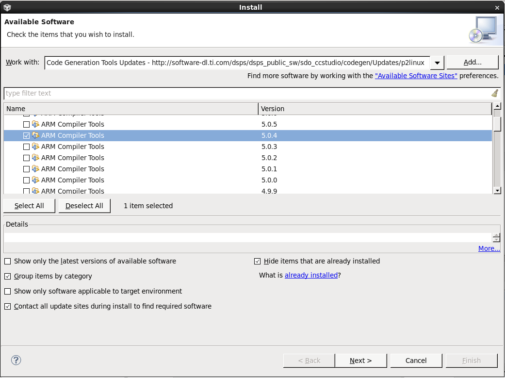

  • Viking said:
    From the documentation you pointed to, I read " if compiler version x.x.x was installed with CCS, you will not be able to install an older version", So I assume it is only possible to add *newer* versions of the compiler, not older, so I can not solve the issue this way.
    Sorry, but link I gave wasn't very clear. You can install an older version. The steps to take vary according to which compiler version(s) you already have installed.
    E.g. if only ARM version 5.1.x is installed (which is the default with a fresh CCS v6 installation) then to install v5.0.4 the steps are:
    1) Open CCS Help -> Install New Software
    2) Select "Code Generation Tools Updates" in the "Work With" box.
    3) Untick "Show only the latest versions of available software"
    4) You can then select to install ARM Compiler Tools 5.0.4 (which is what TivaWare was built with):
    If say version 5.0.10 is installed, and you need to install 5.0.4 (which has the same Eclipse "feature ID") then additional steps are required - see CCS 6.0.0.00190 "Install New Software" prevents installation of older compiler version

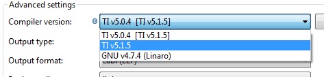

  • Hi Viking,
         Duplication Procedure:
    1. Deleted my qs_iot example program at my Tivaware installation for Tiva Connected Launchpad.
    2. Copied your qs_iot example program at my Tivaware installation for Tiva Connected Launchpad.
    3. Build and got three warnings below
      1. variable "tcphdr" was set but never used
      2. variable "tcphdr" was set but never used
      3. This project was created using a version of compiler that is not currently installed: 5.0.4 [ARM]. Another version of the compiler will be used during build: 5.1.5. Please go to CCS App Center to install the compiler of the required version, or migrate the project to one of the available compiler versions by adjusting project.
                               Note: As mentioned you can migrate the project to one of the available compiler versions by adjusting project.
          Solution Procedure:
    1. Go to CCSV6 Project Properties and adjust compiler version to TI v5.1.5. See, below.
            After build I only get two warnings of "variable "tcphdr" was set but never used".
