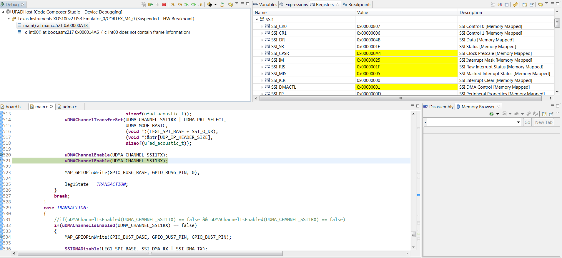

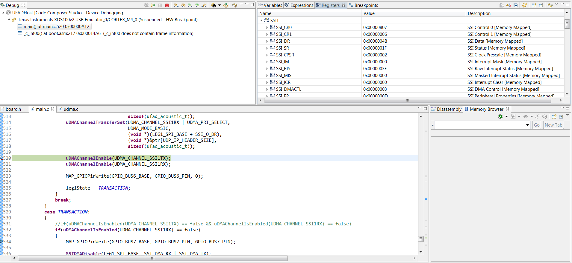

I'm working on a custom board utilizing two custom board featuring a TM4C129ENCZAD. The Tiva interfaces with another microcontroller via two SPI buses (SSI0 and SSI1). For TM4C129 is configured as a slave using mode 0 and with a 6.25Mbit clock rate. I configured the first bus (SSI0) to use uDMA for both RX and TX and it works great. When I duplicated my efforts for the second bus however things are very diffferent. They both have their own DMA channels but it seems when I go to enable UDMA_CHANNEL_SSI1TX it changes all the settings in the SSI registers. I provided two screenshots, one before and another after where you can see this happen. Any help would be much apprecated.

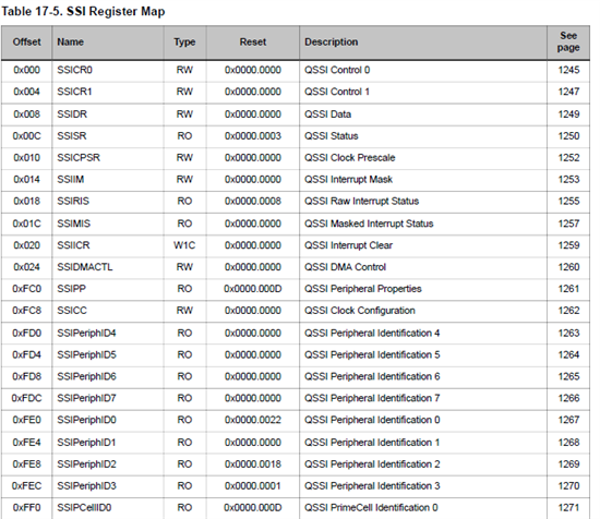

    Change the destination address to see if it also gives you those erros, reason i am saying that is because you have a ARB of 4, and also a destination incrementation of 8 bits, that means you don't keep writing data into the FIFO, but istead you are writing it to the other registers, notice that the registers that change are after the SSI_O_DR
  • Luis,
    You're right, it did not corrupt the other registers. Could you explain this to me a bit more, specifically about how arbitration works? I changed all foru uDMA channels to arbitration of 1 and also disabled burst and everything works now.

  • You were just messing arround with the SSI registers and you can se in the table below that every 4 bytes, you have another register that configs diferent things. You were cycling the destination address through the 4 bytes of each register.
    Now about the FIFO. You only have the DR to store data, the SSI will store it in the fifo everytime it receives it, while the FIFO has space in it
