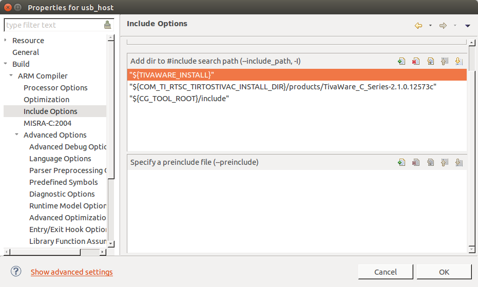

Below is a screenshot of my include options, I can provide more details of my project properties if necessary.
I'm using versions
2.1.0.12573 of TivaWare.
6.0.0.00190  of Code Composer Studio
14.04 Ubuntu

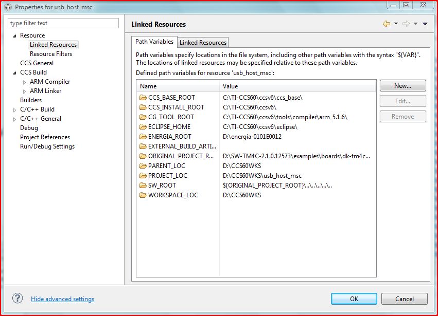

    By default, the path to SW_ROOT was set to ${ORIGINAL_PROJECT_ROOT}/../../../../..
    Path Variables
    SW_ROOT = /home/krithik/Development/tiva/tivaware
    Build Variables
    Driverlib
    The link to driverlib.lib was missing, so I added that relative to the path SW_ROOT

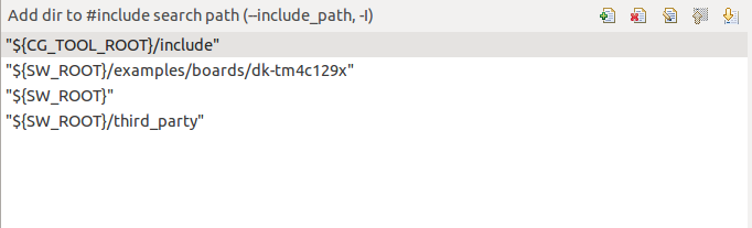

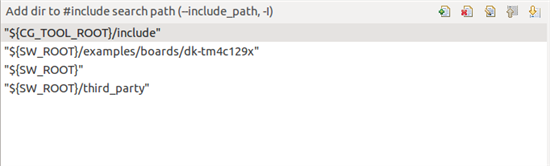

    Include Options

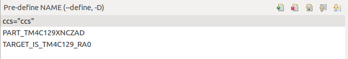

    Predefined Symbols

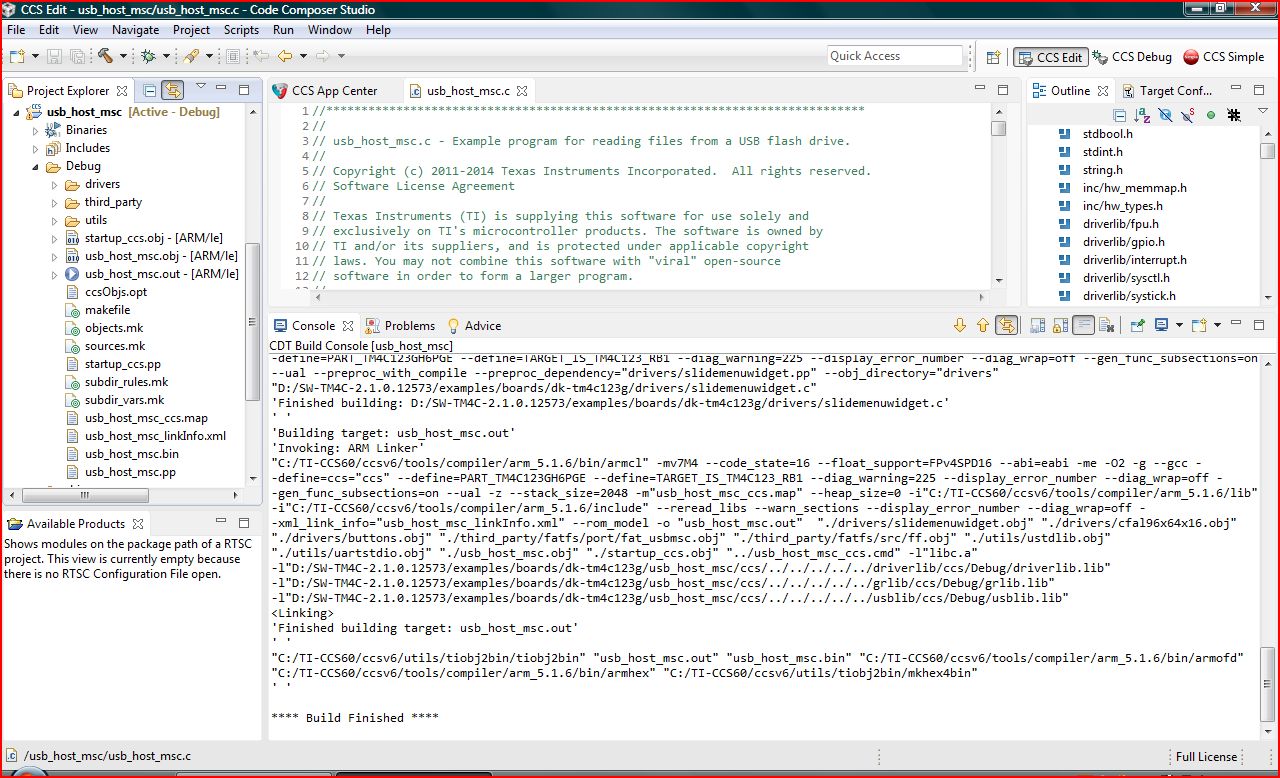

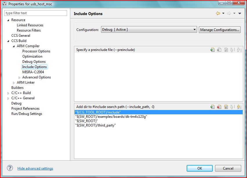

    I am not sure if you really imported the project or just copy-pasted it. Below are some picture from my setup (Win, not LX) but should be used as references. What to look for are as follows:
    In the above picture ignore Energia_xxx, it is mine use, you do not need it.

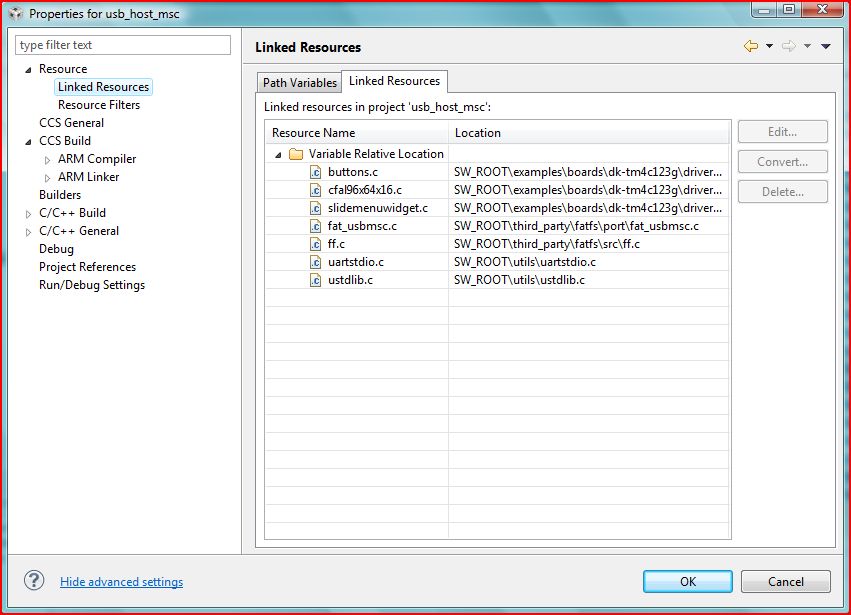

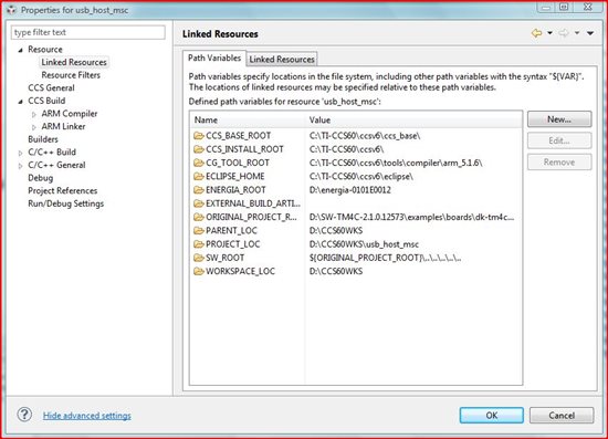

    In the above picture, take care to have the message: Variable Relative Location. If you have the word "Absolute" for any item, then select each item with Absolute qualifier, and press the button Convert... at the right to convert it to relative paths.
    This is for compiler included options.

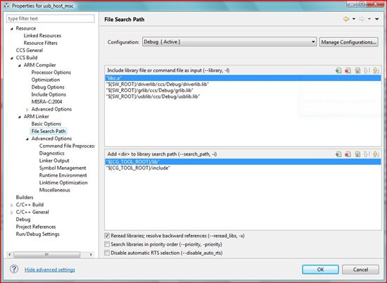

    Here are the graphics libraries added to the linker. This one is missing in your settings.
    And the final build result:
    Compare these settings with yours. Repeat the importing the project - take at most 5 minutes (for me, taking the pictures...)
    Importing is started from Project | Import CCS Projects..
    Petrei

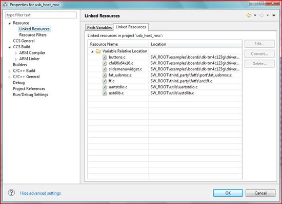

    I was finally able to solve this! No errors or warnings after the build. The screenshots really helped :)
    Essentially my Linked Resources Tab was blank, unlike yours which had all the necessary third party files. I added them, with a relative location. Not sure why they didn't get added when I did in fact simply import the project.
    Thank you so much!
    I suggest to try importing one or two more projects and if the result of Linked Resource Tab is still empty, then it is wise to complain about at CCS forum for inspection/corrections - could be related to CCS implementation on Linux - helps also for other users.
