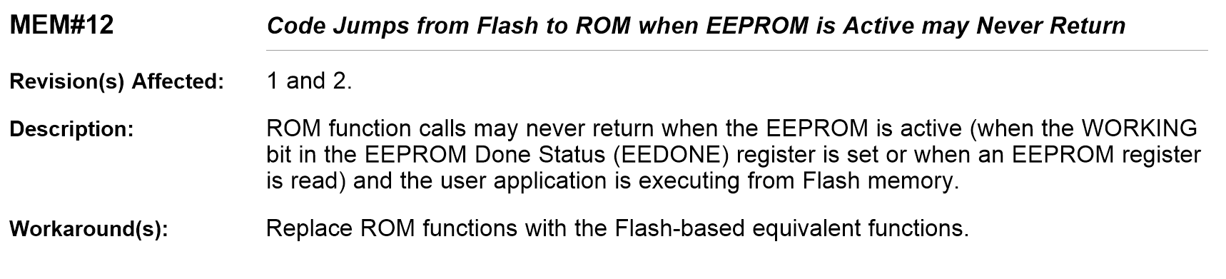

Hey guys, I have a quick question regarding the MEM#12 item from the TM4C129 Silicon Errata. The specific item is shown below:
Does this apply to any jump from Flash to ROM execution, or only those where the ROM code is actually interacting with the EEPROM? The wording hints at the former, but I'd just like some confirmation that I'm not misunderstanding this.
  • Hello Matthew,
    It is the latter, i.e. when a function in ROM is being called while EEPROM is actively writting or reading. This can be the case when doing a EEPROM Write or Read operation and an interrupt handler is called which has ROM_ function being used while the EEPROM operation is ongoing.
    Amit
  • Hey Amit,
    Thanks for the quick response!
    I think you might have misunderstood my question. I understand that ROM calls during EEPROM reads/writes might not return, but I wasn't sure if it was ALL ROM_ calls (e.g. ROM_SysCtlDelay()), or just those that actually deal with the EEPROM itself (e.g. ROM_EEPROMRead()). From the wording I feel like it is every single ROM call, but I'd just like to double-check before switching a chunk of my library calls from ROM to Flash in a project.
    Thanks again,
  • Hello Matthew
    Any ROM Call can cause the issue. Please do note that it is fixed in the revision-3 of the device
    Amit
