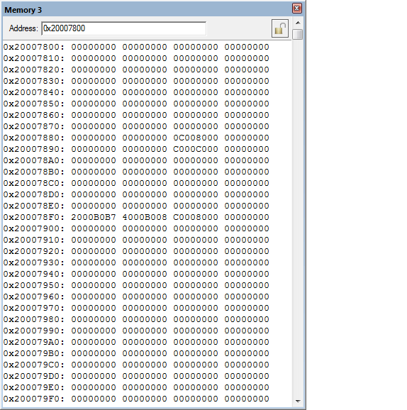

SSI_DMATX is not generating an interrupt
I'm porting the code from Cortex-M3 to TM4C129X evaluation board.
I'm trying to send data to the flash using uDMA.
the uDMA seems to be working (I can see the clock on the scope), but the interrupt is not triggering (does not go to the SSI3_Handler).
I copied a large section of the code from the example file C:\ti\TivaWare_C_Series-2.1.0.12573\utils\spi_flash.c.
It must be something very simple, but I'm not able to find it.
Please help.
I'm attaching sections of the code below.

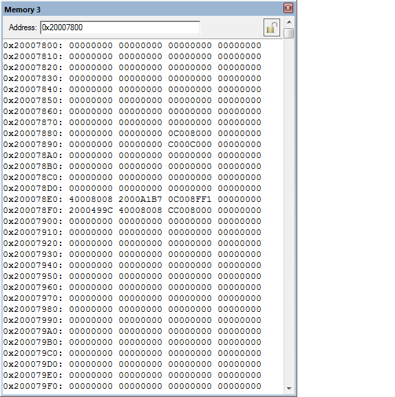

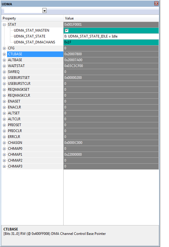

    I aware of the pin swapping and its already been taken into account.
    My problem is not the data on the line ( I can see the clock, and the data0 line toggling fine).
    My problem is the uDMA done interrupt. For some reason, after uDMA has finished transferring the data the SSI_DMATX interrupt does not get set and the SSI3_handler is not called!
    I checked everything at least 4 times already, and can't find the reason for the missing interrupt, and I don't know what to check.
    Khaled.

  • Hi Amit
    Sorry I sent you the old file. Here is the new one.
    Khaled.

    In hw_udma.h, DMA_CTLBASE is at address 0x400FF008.All words are "0"! (see attached image UDMA_CTLBASE_0x400FF008)
    In the uDMA registers, the address is 0x20007800 (see attached images UDMA_CTLBASE_Register and UDMA_CTLBASE_0x20007800 )
    I'm not sure which one is correct. It seems to be the later since there are values for uDMA channel 15.

  • Hello Khaled,
    The address to use is from DMA_CTLBASE 0x20007800
    I do not see the IM bits being set by the software nor do I see the DMA Table having any entry for Channel 14. May be you have bot run the code till the place where you enable the read channel.
    Amit

  • Hello Khaled,
    Make sure that no view into the register window is open when running the code. If the IDE starts reading the data from the SSI, then DMA may not get a DMA request.
    Also can you please send a snapshot of the uDMA registers as well?
    Amit
  • Hi Amit,
    Close all the open register windows, run the code until it broke in the SSI3_Handler.
    The results are exactly the same as the one that I have sent in the previous e-mail.
    I'm attaching the uDMA register view below.
