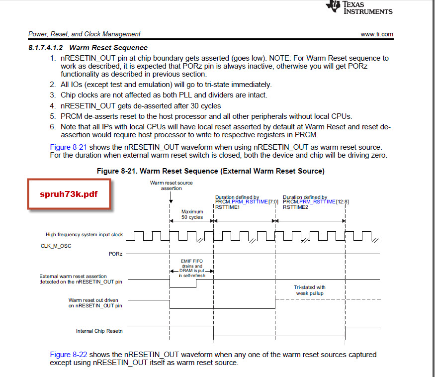

Hello Support,
In the spruh73k.pdf for Sitara device there is a timing diagram related to External Warm Reset assertion as shown below.
Is there a similar diagram for Hercules Device Family for nRST Pin being asserted from outside world?
Can you please send me a similar timing diagram for TMS570LS0432 device?
Thank you.
Pashan
  • Pashan,
    Our power on reset diagram is Figure 4-1 on page 26 of spns186.
    the nRST pin would be extended in duration after nPORRST is released by the timings specified in table 4-6 however there are other causes for nRST than just the nPORRST power on reset.  Theses causes are listed in Table 4-5 and can occur at any time.
    For an externally asserted reset (last entry in table 4.5) the nRST pin includes glitch filtering which is spec'd as well in table 4-6.
