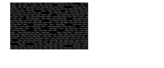

Sir ,using the below program i am trying to flicker led .For generating pseudorandom numbers i am using lfsr technique.To check if i am getting the random number or not i am displaying it on the serial monitor using uart.The output which i am getting on the serial monitor is garbage value,along with that ,no flickering of led is hapenning.

  • Hello Mahavir
    1. The LED will not flicker as the value computed in bit is either 0 or 1. The GPIO Pin write works by writing the value of the Pin when using the pin. The function must be modified as
    GPIOPinWrite(GPIO_PORTF_BASE, GPIO_PIN_1,(bit << 1));
    2. What is the garbage value that is coming and how do you expect it proceed. Then compute the same manually and what does that show up,
    Amit
  • Thanks Sir,Though I have got the flickering on the led but still i am getting a garbage value on the serial monitor,can u throw some light on that.i am attaching the image of serial monitor below .
    With regards
    Mahavir
  • Hi mahavir
    Without analyzing to much of the code, that seems to be that the monitor settings don't correspond to the UART configuration. What least that's the kind of thing that appears for me when that's the problem
  • Thanks Luis ,for your response
    Luis I have used the same settings for monitor and I have got the desired result for other codes.What I think  the problem may be with this code is the data types of variables.
    With regards
    Mahavir
  • That screen shot appears to be showing individual bytes (that's good) but w/ms (most significant) "bit" set.  Most terminal programs produce best "human readable" output when only the lowest 7 (ASCII) bits are employed.
    You may wish to "strip out" that msb prior to placing that data into the MCU's UART.
