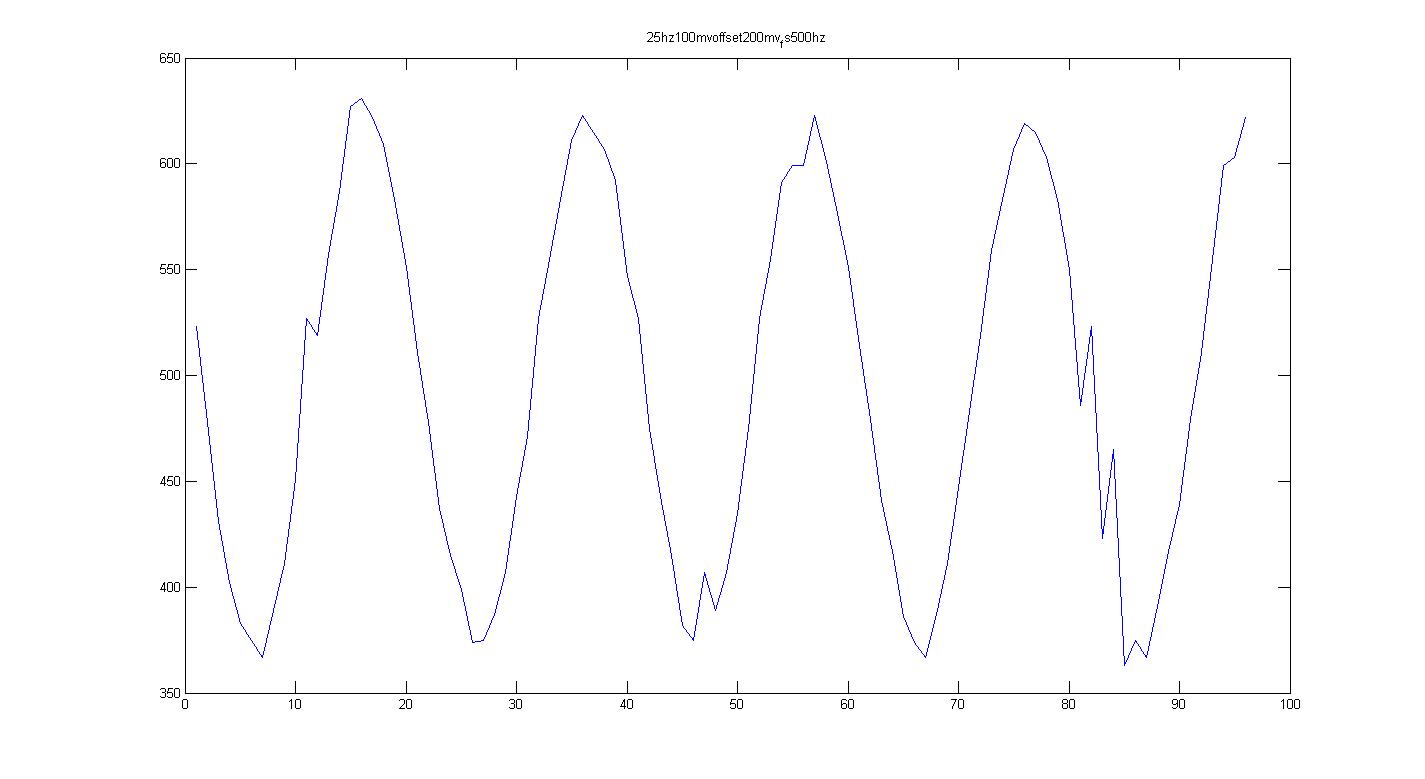

  • Hi
    I am trying to capture data from 4 input sources using 4 channel of a adc in tm4c123gh6pm.I am using keil uvision4 for debugging.But I am not getting the samples as expected.I am giving a pure sinusoid from a function generator.But it looks like I am getting improper output samples.Please suggest me if i am doing anything wrong.I am attachin gmy code below.

  • Hi
    Arunabha, you need to do ADCSequenceDisable before you configure it. So i guess configuring it to a diferent chanel doesn't realy work.
  • Thanks for ur reply.With ADCsequencedisable() I have tried but the same problem.Sometimes i am getting two consecutive samples of one channel is same.If I set  time loading value to 20000 instead of 5000 then I am getting a more proper output.But in this case my sampling frequency has been equals to 0.5ksps considering the 4 channels together.i want a sampling frequency of atleast 1 ksps.Quite confused.
    Arun
  • You sure those values are correct?

  • Hi
    everyone,
    I have given a proper sine signal with 100 mv amp,25hz freq+200mv offset to 4 channels of tm4c123gh6pm adc.i am using the same input for 4 channels for experimental purpose..The samples are not coming in a particular order,here i have uploaded my  code and the graph of the data i am getting from one channel.Please have a look.

    This no way looks like a sine what i am giving as input.I dnt understand where i am doing wrong.As per my calculation my adc is working with 500sps for each channel as after 1 ms i am switching the channel and there are 4 channels in total i am using.Why i am not getting a proper data.please help me with this.
    Arun

    According to your suggestion I have implemented the code with timer interrupt.but It seems like I am not getting appropriate sample values as per my input.My input is 25hz,100mvp-p with 200mv offset.here i have attached the code and the graph of the sampled output for one channel.please have a look.I am really not understanding how can i improve the adc output.

    I really have no idea why it is not a proper sine.My input is pure I have checked with oscilloscope.Thaks
    Arun
    a) Usualy, configurations should not be present in interrupts, but in the main program, at the beginning. Starting an interrupt with GPIOPinTypeADC is not a god idea - usually this kind of settings may take several more hidden cycles, due to the need to be synchronized to the high speed cpu bus. And once a pin type is defined, no need to re-type it every millisecond. So, move them outside interrupts.
    b) You do not provide any explanation for choosing multiple pins for a single input sequence (SS3) and you loose time in interrupt by enabling/disabling and configuring the sequencer. Instead, the sequencer 1 or 2 may be used for four channels/input pins, even for a single signal.
    c) Suggest to keep a single pin enabled for ADC, before interrupt and to check/verify such configuration.
    d) Just in case the problem is still present, would be better to find out what is the pin enabled at the discontinuity moment - see if it is the same in all cases or not.
    Petrei
