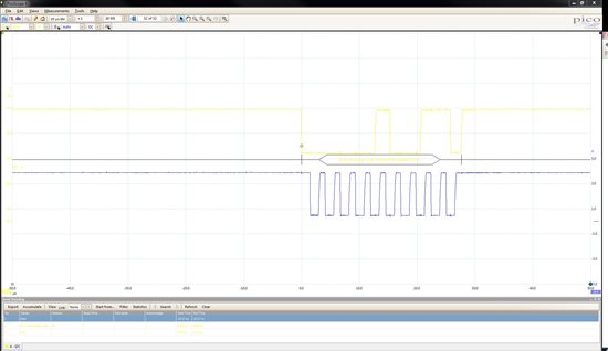

I am trying to generate a master recieve with the TM4C1294 using the MSP430G2553 as the slave sender. However, I believe I have the slave sender correct but I wanted to double check what address I should use in order to send it to the master. Nonetheless, I am not receiving on the master what I am sending from the slave. I have attached my master recieve code below and a snapshot of the I2C bus.

  • Hello Andrew
    The Address being sent to the Slave device is 0x04 as shown in the waveform and as configured in the code. However the Slave is Not Acknowledging the Address being sent to it.
    So clearly it is a Slave problem (unless the Slave Address is not correctly written)
    Amit

  • Hello Andrew,
    Even if the Slave is transmitting to the master, it has to be first selected on the bus. For this Master has to send the Address along with the R/W signal. If the Slave sees it's address it will ACK and only then will it begin transmitting. The code does not seem correct either
